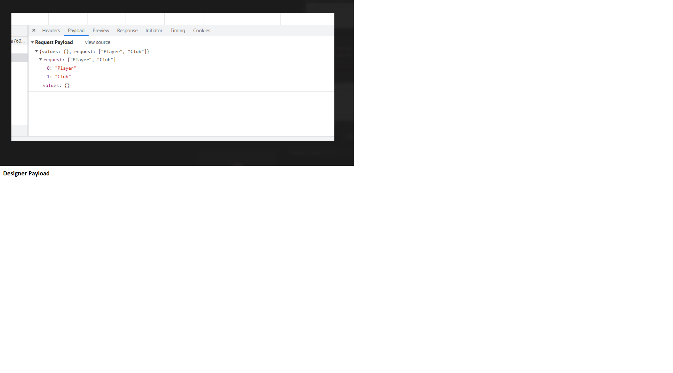

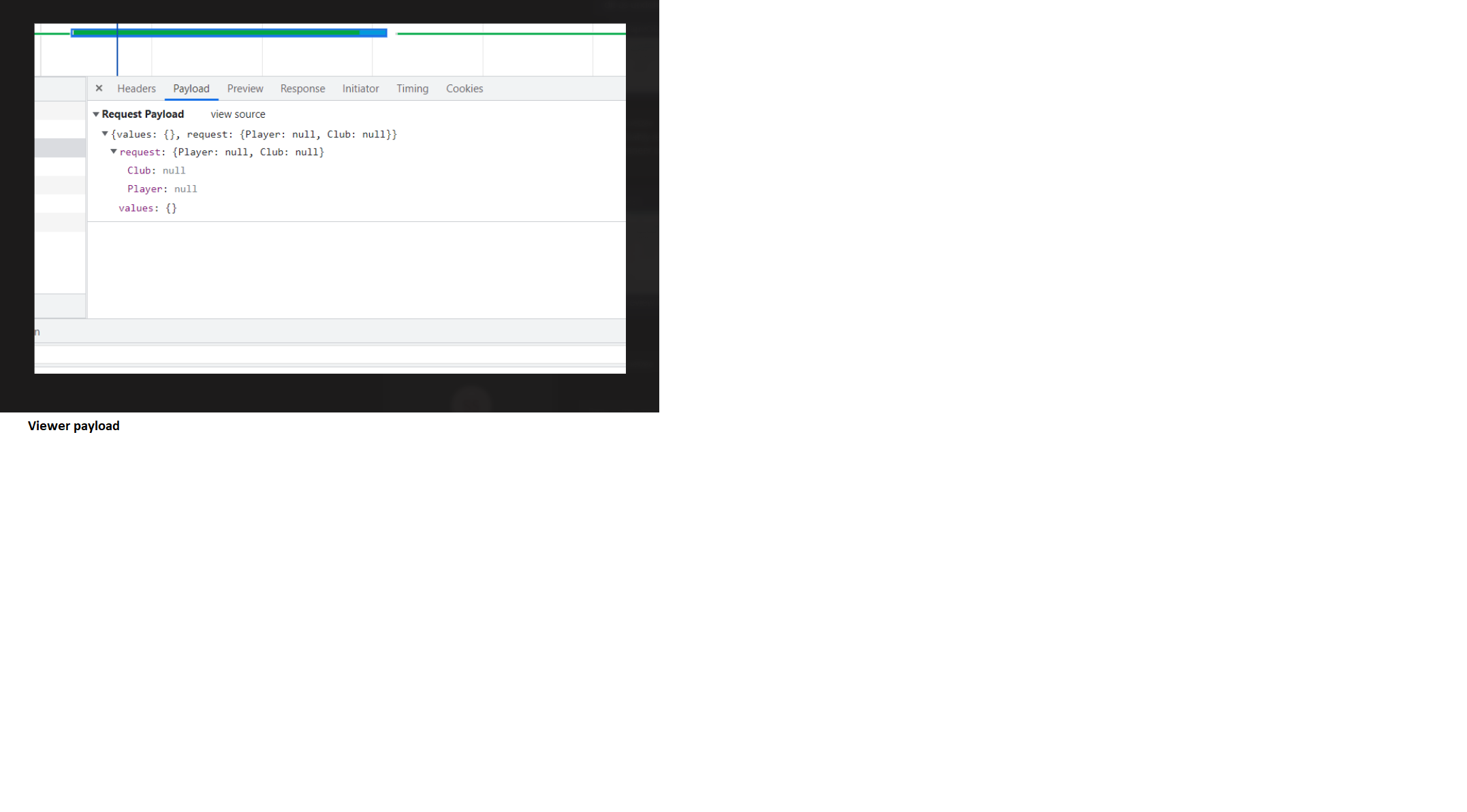

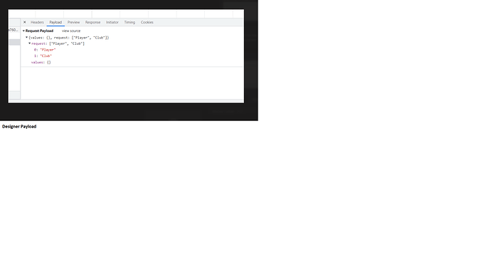

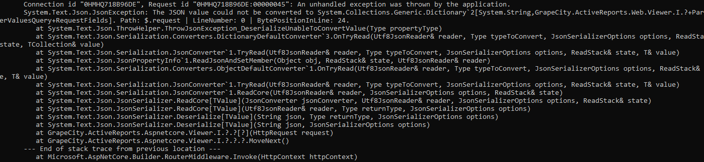

We are currently experiencing a Network 500 error issue when parsing a parameter via code when trying to render the report. The viewer is currently working when passing this type of request whilst the designer is failing to render. There seems to be a difference between the 2 request payloads. Please see attached screenshots of the payloads including the error.
