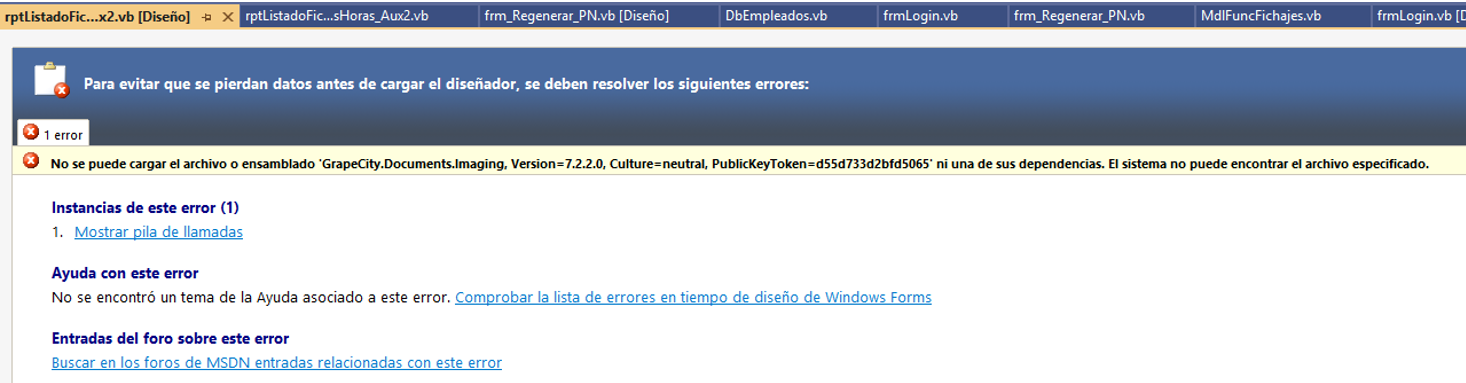

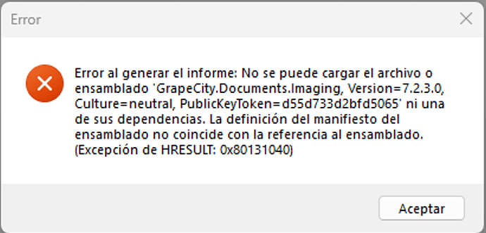

    Last week I installed version 18 on my computer and converted my project.
    I upgraded all the packages…

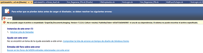

    Now, when I open the project in the report designer, I get this error (Image1).

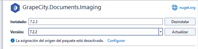

    To solve the error, I have to downgrade this package (Image2), and then I can open the designer, but I get an error when I run it.
    If I upgrade the packages again, it works fine.
    The problem is that if I close the project, when I open it again I get the same error and have to repeat the process.
    Can someone help me?
  • Posted 15 September 2025, 2:37 am EST
    Hello Jose,
    Apologies for the inconvenience caused.
    ActiveReports designer needs the particular version of DsImaging API to work and for ActiveReports 18, it needs to be version 7.2.2.
    We suggest you to check your project file and set the DsImaging reference version to the particular version.
    If you still face the issue, please share your stripped-down sample replicating the issue so that we can assist you further accordingly.

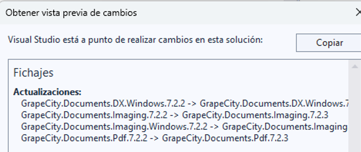

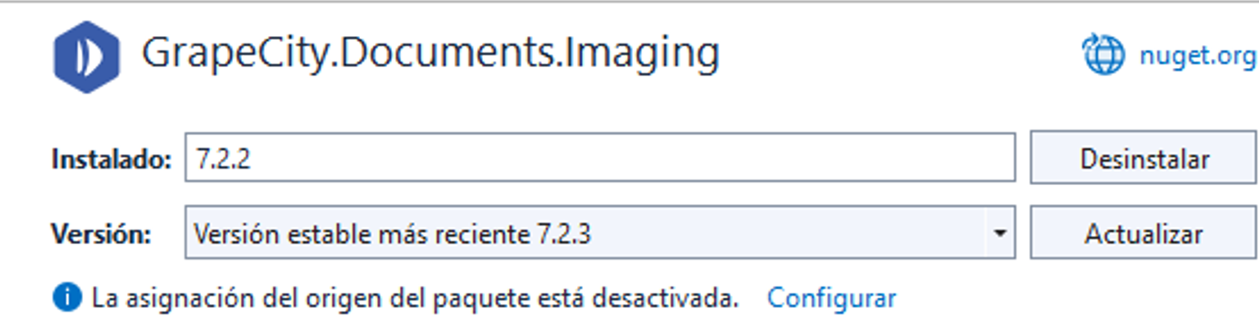

  • Posted 15 September 2025, 3:39 am EST - Updated 15 September 2025, 3:44 am EST

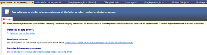

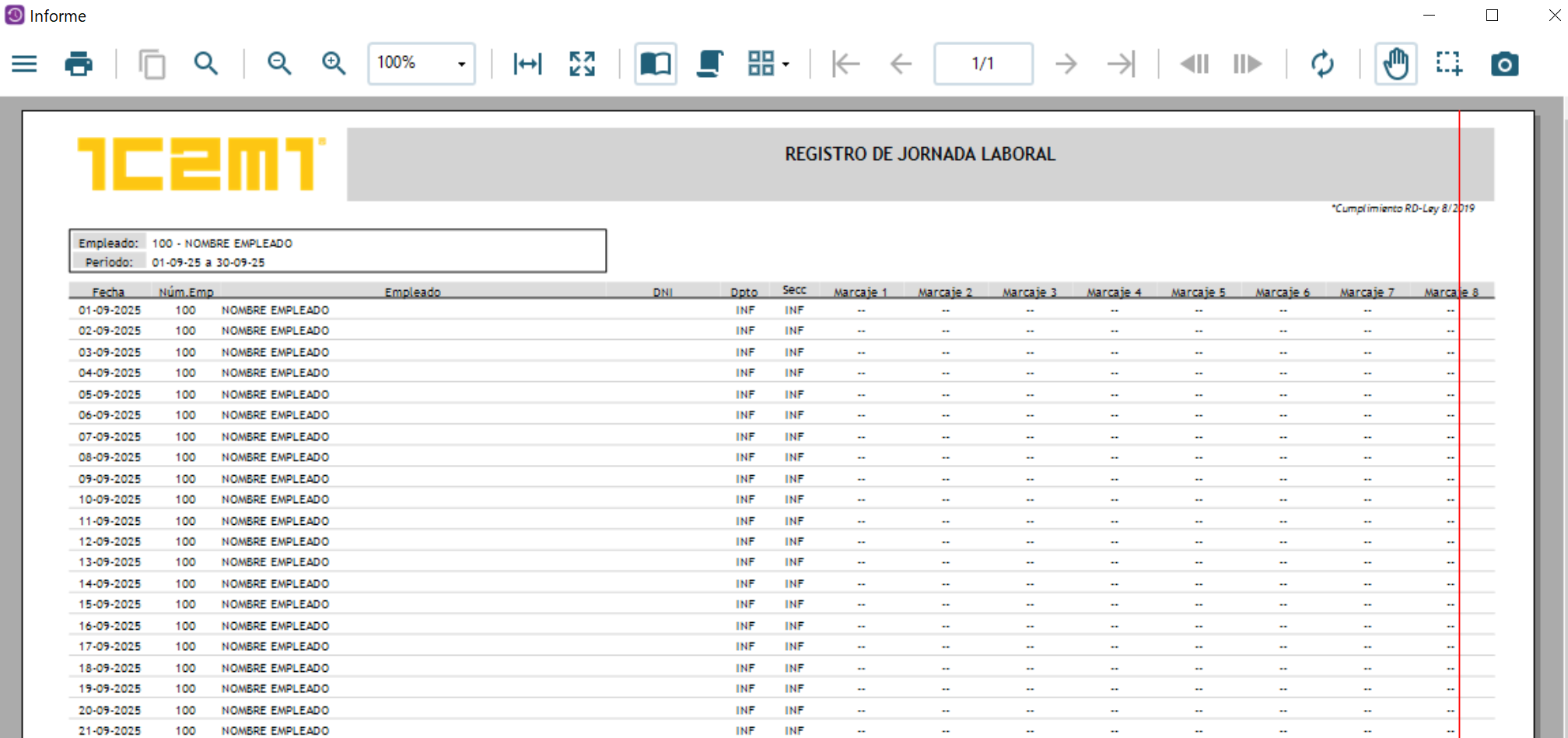

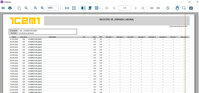

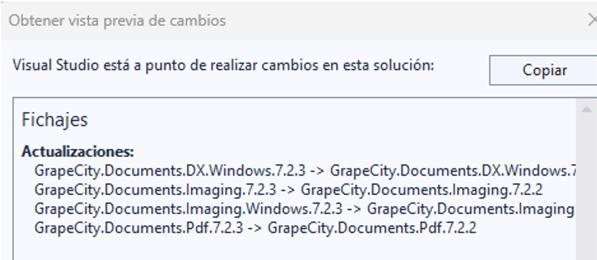

    1. Open Project
    2. It shows the error
    3. Downgrade the file version from 7.2.3 to 7.2.2
    4. These files are updated
    5. Once they are updated, I close the report designer and open again correctly.
    6. I run the project and try to run a report, but I get this new error:
    7. So, I update to the version 7.2.3 again.
    8. The same files are updated again:
    9. Now, I can open the designer and show the report without errors.
    10. I have to do the same thing every time I open the project.
    I can’t run the project with the version 7.2.2. I can not see the reports.

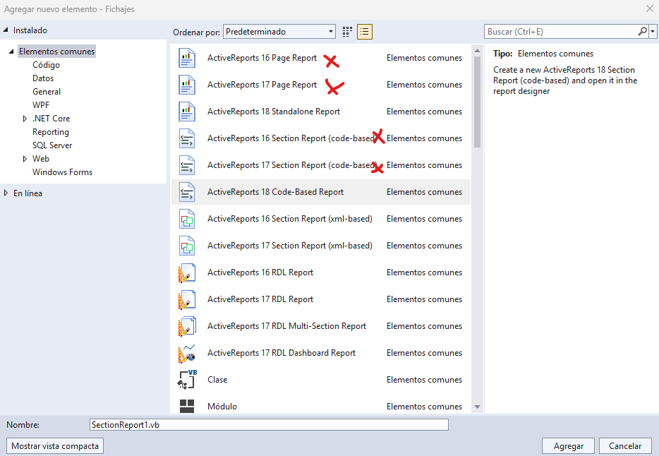

  • Posted 16 September 2025, 5:22 am EST - Updated 16 September 2025, 5:27 am EST
    Ok, It works fine!
    One more thing.
    When I am going to add a new element, I can see the reports of old versions, 16 and 17 in my project.
    Should I keep or remove these old versions?
    How can I remove the old versions (16 and 17)?

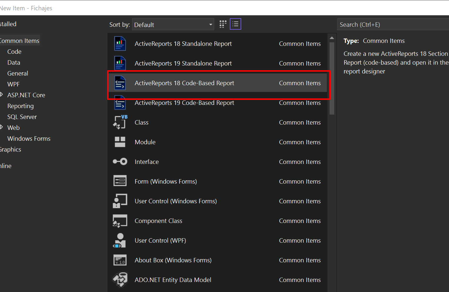

  • Posted 17 September 2025, 12:01 am EST
    Hello Jose,
    It seems ActiveReports 18 version is not installed in your machine. You can install the latest version of AR 18 from the given link:
    https://cdn.grapecity.com/ActiveReports/ar18/ActiveReports-v18.2.3.1534.exe
    You can uninstall the old version directly from the System’s control panel.
  • Posted 17 September 2025, 2:50 am EST
    Now, when I open the project and when it is running, everything is ok.
    I have updated the 18 version, but the templates are the same as the last picture.
    I think it is not a problem for me at this moment.
    Thanks for your help Prabhat.
