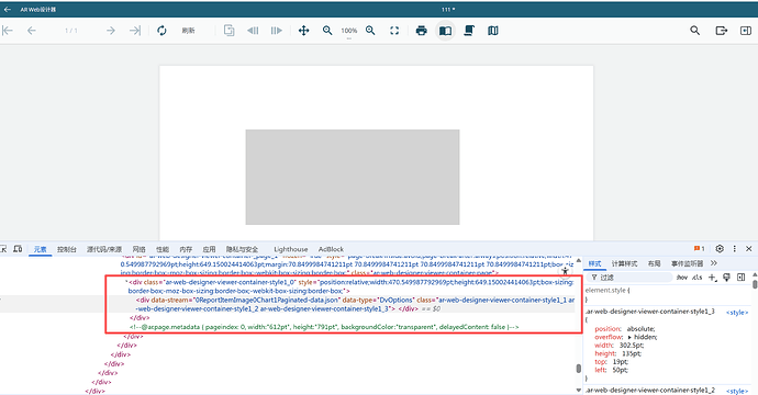

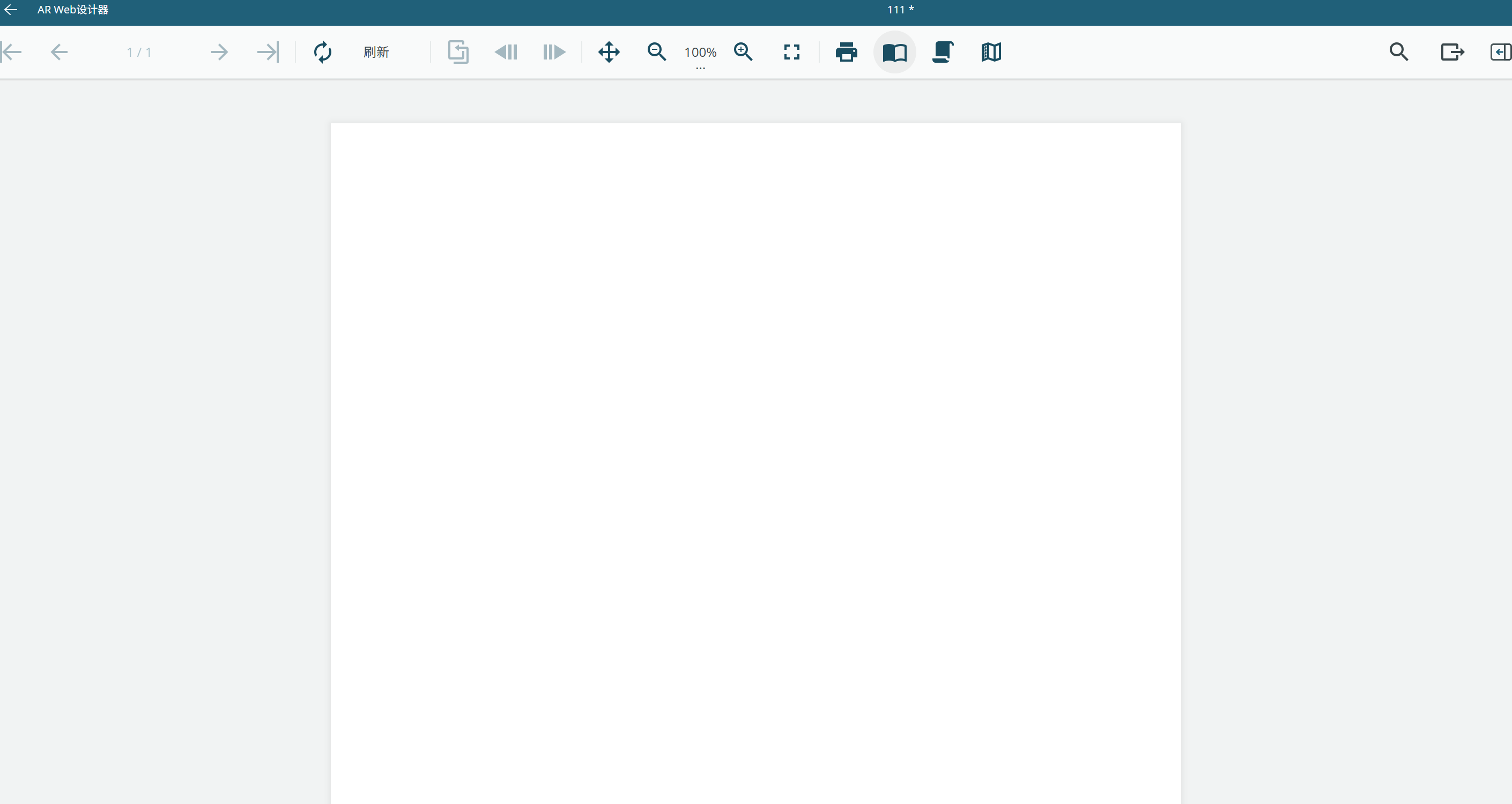

Chart can not show on web in AR 18.0.4
Posted by: michael.zhong on 10 September 2025, 8:33 am EST

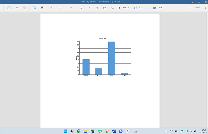

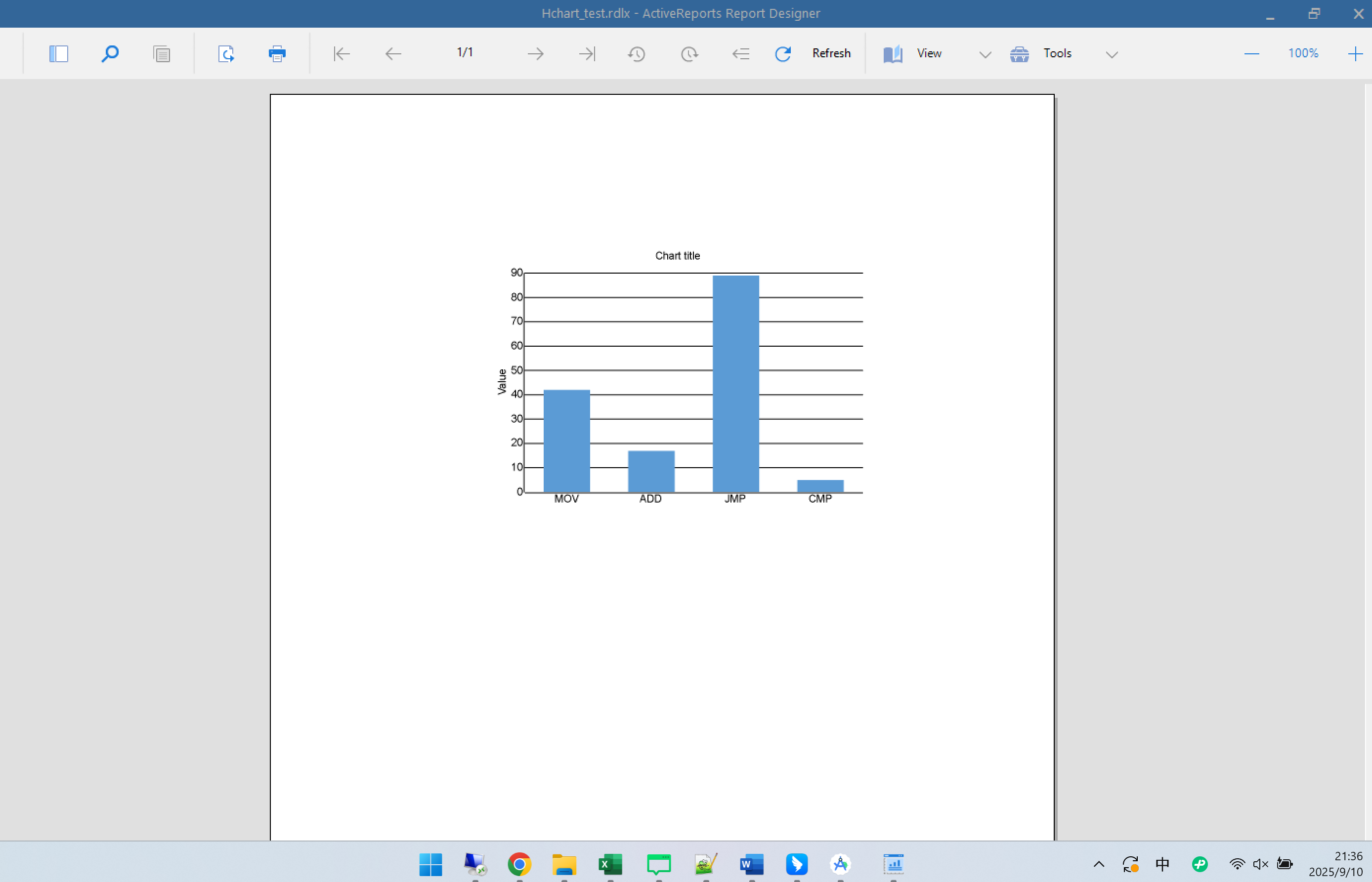

Posted 11 September 2025, 3:26 pm EST
Apologies for the misunderstanding.
The report we were using before is created via ActiveReports 19 designer so it was not rendering in the ActiveReports 18 designer.
Please find the report file created via AR 18 designer and working fine in the designer as well.
test1.zipIf you still face the issue, please share your stripped-down report so that we can assist you further accordingly.

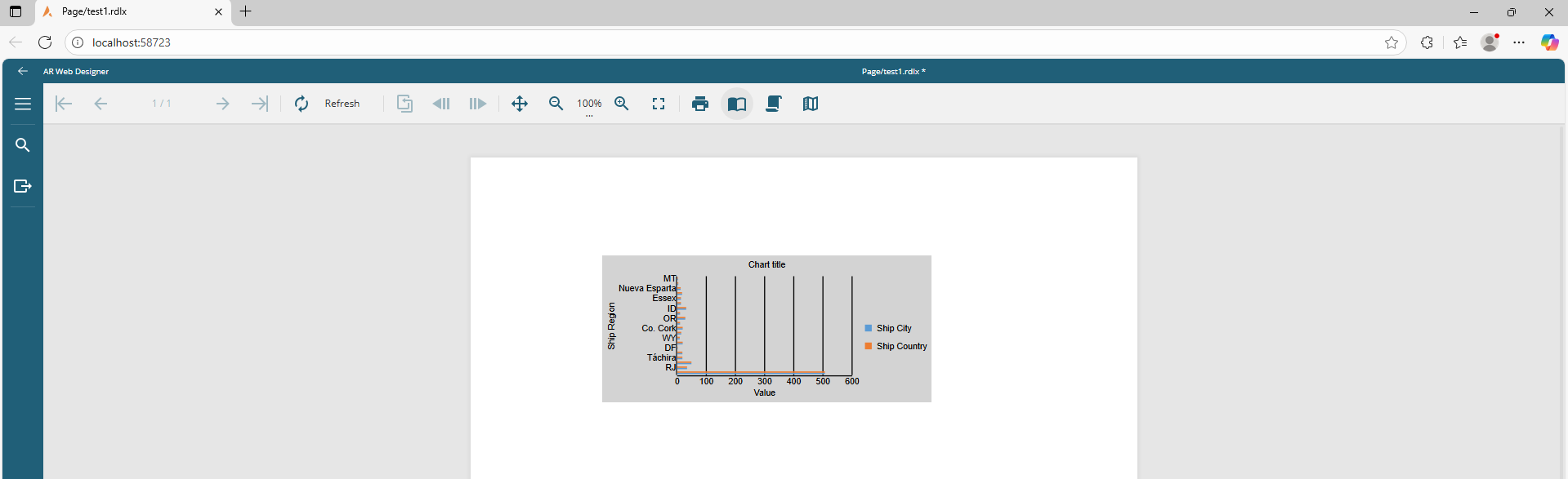

Posted 12 September 2025, 6:51 am EST - Updated 12 September 2025, 6:56 am EST
Thanks for the detailed screenshot!
We tested this scenario using the WebDesigner_MVC product sample using the same report we had attached, and we were able to preview it in the Designer along with that we could see the chart rendering correctly in the viewer. Please see the attached screenshot for reference:
For your convenience, we’ve also attached our working sample. Could you please try with this sample on your side? You can follow the steps below:
- Run the sample
- Click on File menu
- Double-click the Page folder
- Open test1.rdlx
If the issue still occurs after comparing with our sample, we would appreciate it if you could share a stripped-down version of your project where the problem can be reproduced. This will help us investigate further.
