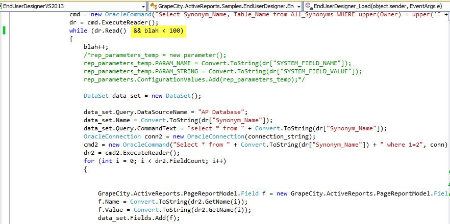

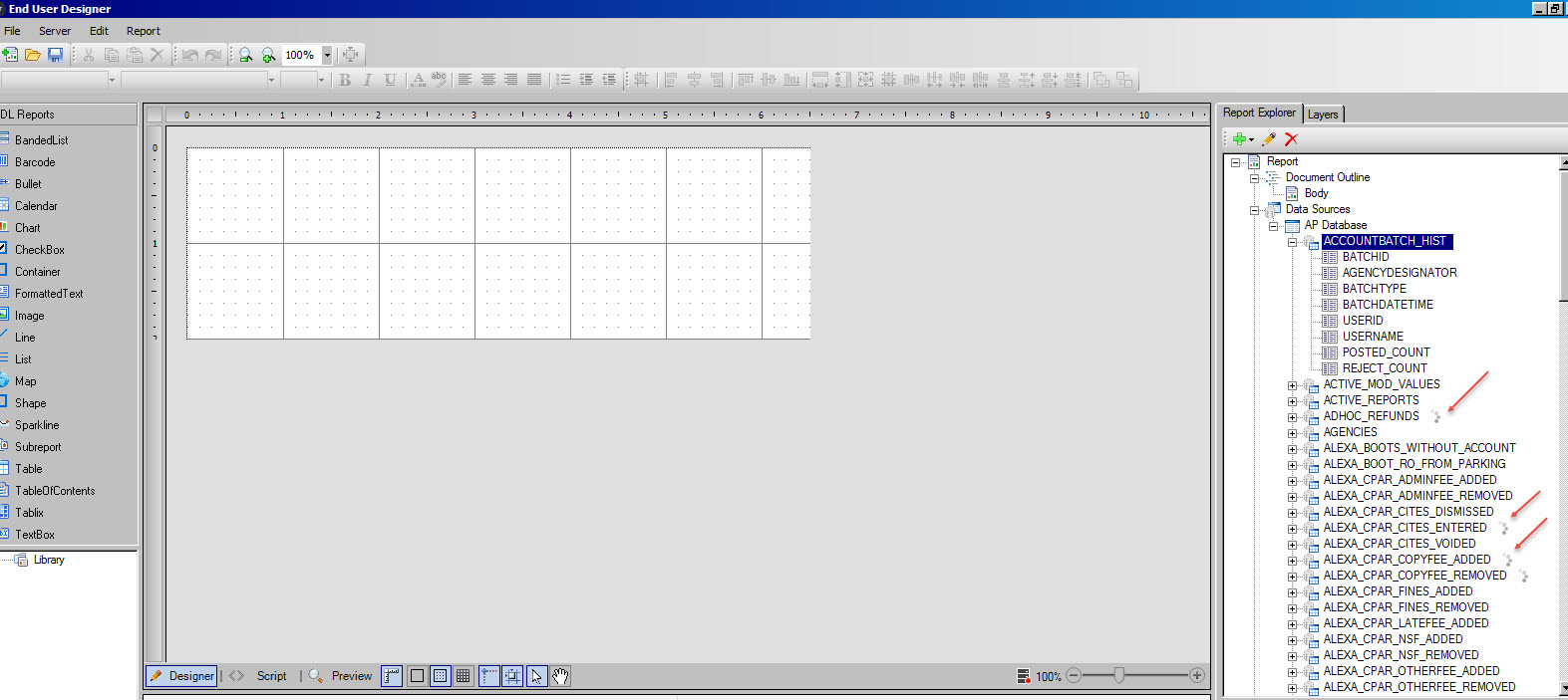

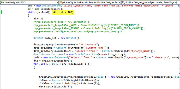

    When I try to pre-populate tables with fields information of 423 tables into the End User Designer before loading it hangs indefinitely on a line of code I have in to refresh the Report Explorer control. If I limit the number of tables to pre-load to 100 tables then it’ll load after a little while but I see a busy indicator next to a few of the tables.

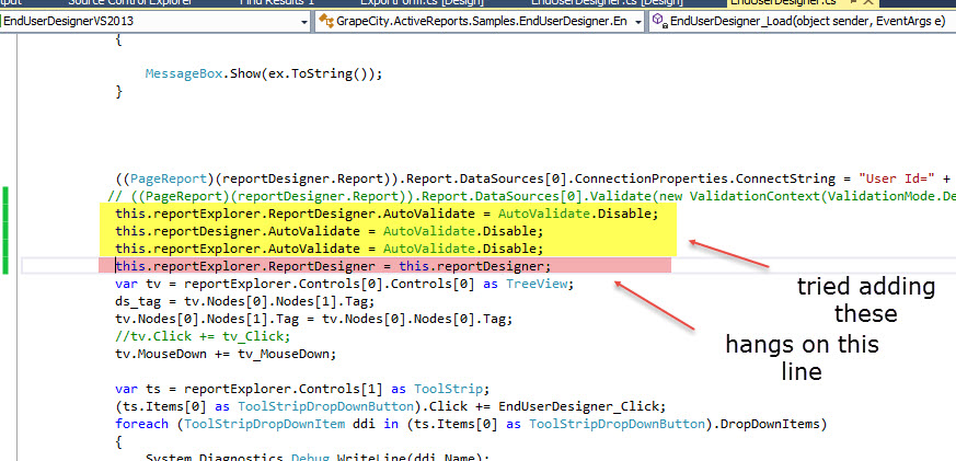

    I tried various commands to disable validation in hopes that it would prevent whatever is causing the hanging on the load time. Other properties I tried was lockcontrols and disabling and re-enabling the reportexplorer before and after loading but haven’t found anything that has helped yet.

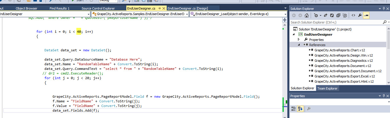

    Sure I have a slightly modified end user designer from active reports 12 in the attached zip file.
    EndUserDesigner.zip
    If I make this variable 40 to load only 40 tables when the app loads, there isn’t much problem with load times.
    but if I change the variable to a higher number like 400 then it hangs. Assuming there isn’t a way to load the application in a reasonable amount of time I’ll probably just code a work around where the user can select from a list of what tables to add as they need them instead of trying to add them all

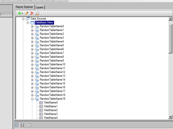

    I am unable to reproduce the issue at my end. It takes only 20 seconds to load 400 tables. I just modified to add the table from the SQL database as follow:

    Could you please confirm If I am missing something at my end.

    Have you added fields along with datasets through the code in your original projects? Also, please try after using the following in your project.
    ValidationContext vc = new ValidationContext(ValidationMode.BeforeProcessing);
                       data_set.Validate(vc);
    Hope it helps.

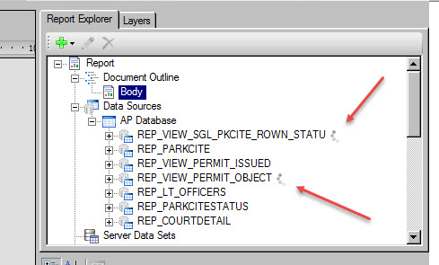

    Thanks the code fix you suggested does seem to have helped in the project I included in this thread. But when I try to apply this same fix on the main project I’ve been working on it still hangs when trying to refresh. Any idea what would cause this waiting indicator to appear next to the tables listed in the dataset?
    Yes in the report load event I have it query each table and grab the fields of that table and add the fields there in code. I’m thinking that when it comes to the report explorer control when adding the tables in through the code and all of the code workarounds put in to get it to not show database credential information causes it to behave a bit laggy.

    Could you please explain what do you mean by refresh here? Are the datasets loaded correctly when designer open the first time? How are you refreshing the fields here? Yes, customizing the report explorer may effect on the performance.
    Ideally, these wait icons appear when designer executes the query in the dataset and retrieving the fields from the database. However, in your case, the wait icon should not appear as we have already added the fields from the database through the code. In my understanding, there must be something in the code which make the designer execute the query even after the fields are added through code. Is it possible for you to send the code of the original project so that I can look into this and find the solution accordingly?
