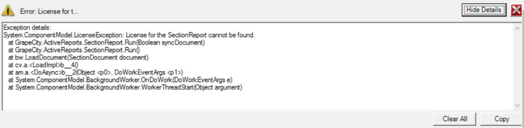

    While loading a report, I am getting an exception as system.ComponentModel.LicenseException: License for the sectionReport cannot be found.
    Can somebody guide me this, How to solve this Exception.

    I have used the same license in other two projects in windows application which is working fine. Now i am trying to use in third project and i m getting the below:
    error

    Hello Trisha,
    Do you have the following entry in the “Licenses.licx” file
    GrapeCity.ActiveReports.SectionReport, GrapeCity.ActiveReports
    Also, could you please explain more information:
    1: Version of AR that you are using
    2: Structure of your application.
