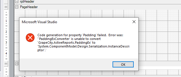

  • Posted 23 July 2021, 9:36 am EST - Updated 30 September 2022, 3:23 pm EST
    Hi Mohit,
    Using AR 15.1.3
    I thought adding a new report to my project would help.
    Some references were also added
    The name property still is not available.
    But now I can’t even save a modified report. Everything seems to be broken now.
    In a new project with a new report added, the name property is available.
    The background color is also white and not grey like the upgraded reports.
    Hope you can figure out what is going wrong here. There are a lot of reports involved.
    Regards Piet
