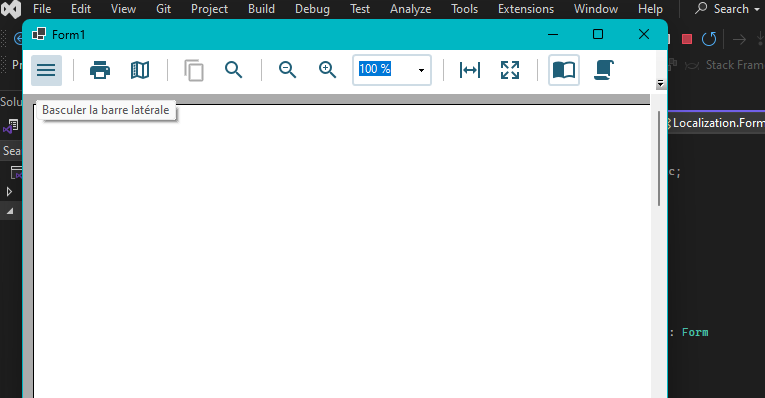

    We have created a WinViewer sample using the localized DLL (We have only changed the content for the toggle sidebar button) for you to reference.

  • Posted 1 July 2025, 1:05 pm EST
    Hi Anand,
    I rebuilt the resource libraries as you said. Then I replaced the MESCIUS.ActiveReports.Viewer.Win.resources.dll file in your program with my own MESCIUS.ActiveReports.Viewer.Win.resources.dll from the compiled package for fr-CA and saw that it was fully applied in your example.
    But I still can’t achieve this effect for the standard EndUserDesigner example. I even added the AssemvlyResolver event handler there and loaded the necessary resource libraries, but they still are not applied in this example.
    Could you please tell me why my resource libraries are applied to your example and I see that they work, but they are not applied for EndUserDesigner?
