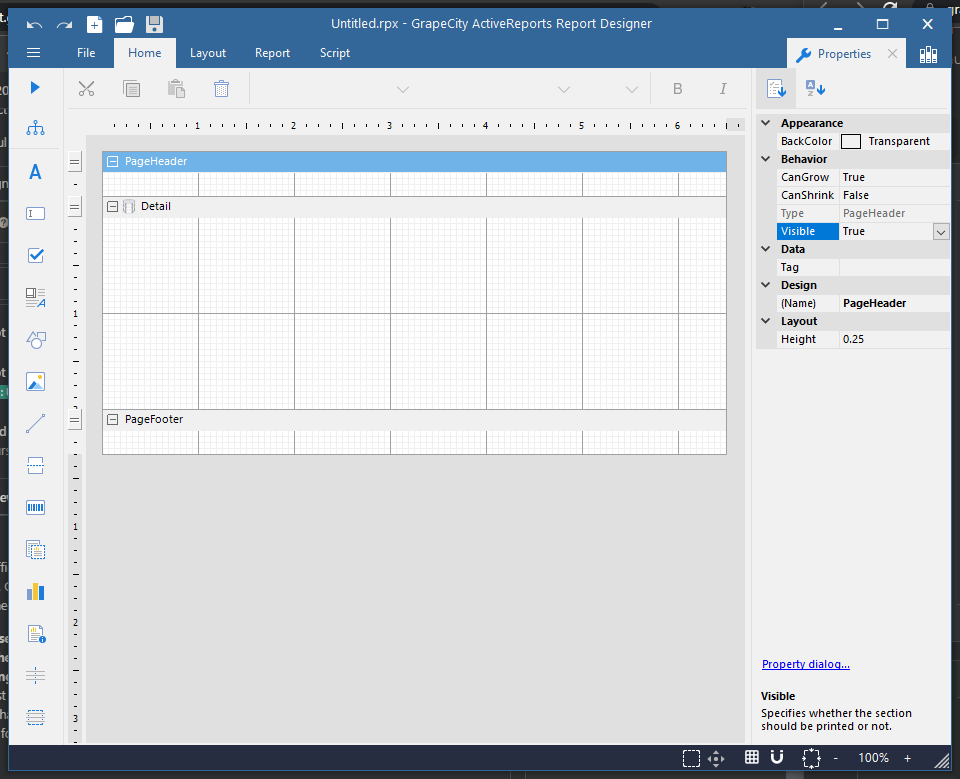

    We tried to test the CanGrow behavior of PageHeader in ActiveReports 14 however, it seems to grow as expected if a shape contained within it is larger in height than the PageHeader. Please find attached a report sample for the same.
    Also, please make sure the ‘Visible’ property of your PageHeader is set to ‘True’ (see attached image).
