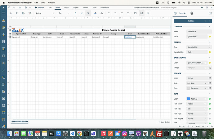

    I tried to use a column Named Errors and put Action Type Jump to a url in that column property and i provided a url in that case, but what i actually want is if i can have a link click event or cell clicked event then i will be able to make the row data downloadable,
    my whole idea is user should be able to download individual row data in json format file.

    in this you might can see that for download i will require a click event or somehow i can add html to the rows, or else so that i can download it
    Please provide me any solution what i can do in that case
