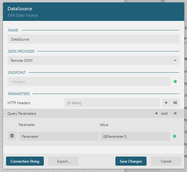

    Hi, thanks for the help, if you can answer me this also
    1. Can I dynamically set query parameters to API, for example if I want to have a custom start/end date, some random parameters or sorting and can switch beetween them?
    2. If not is there a way to dynamically send parameters in report?
    Thank you in advance, if I need to explain in more detail I will
  • Posted 22 November 2023, 7:56 am EST - Updated 22 November 2023, 8:01 am EST
    Hi Danijel,
    Yes, you can pass your parameters dynamically to your report by assigning your parameters to the ‘ReportParameters’ property after which in the query you can add a ‘Query Parameter’ and bind it to your report parameter so that when the API call is made to your report it uses the parameter you passed into your report dynamically through code.
    To learn more about dynamically passing your parameter please refer to Report Viewer Component - Setting Parameter Values.
    You may also refer to the attached sample implementing the same.
    Anand
