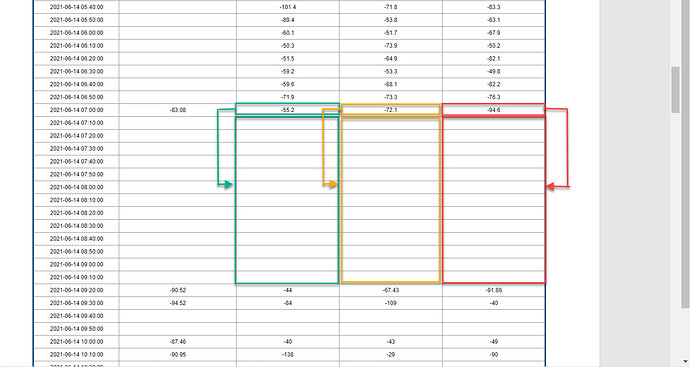

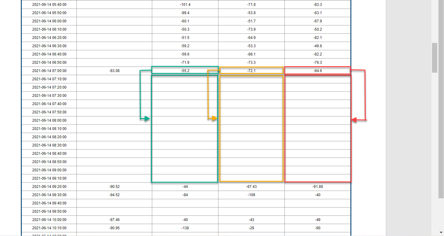

    There are some cells which the values are empty(null).
    I want to fill those cells with the value which is located right above empty cells.
    Is there a function that can make it?

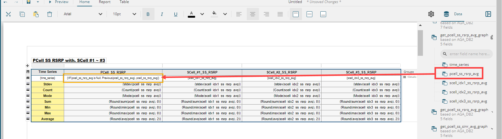

    Below is the function that I used as.
    {IIF(pcell_ss_rsrp_avg is Null, Previous(pcell_ss_rsrp_avg), pcell_ss_rsrp_avg)}
    If you know the method, please let me know.
    Attachment #1 : Desinger Mode

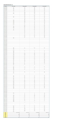

    Attachment #2 : The report I exported on Preview Mode.
