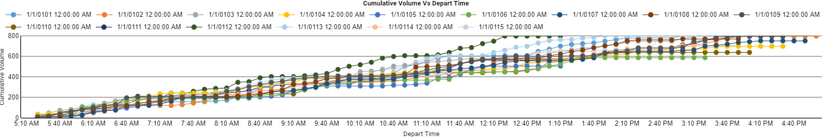

    I have a string value of number type (like 101, 102 etc) in my datasource which are getting converted as date type when I use it in line chart.

    Hi, the line chart in the attached report has the “t”(short time) format is set for X-axis labels, so it shows values as observed. Could you clarify what’s the expected behavior?
