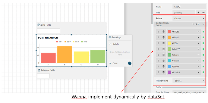

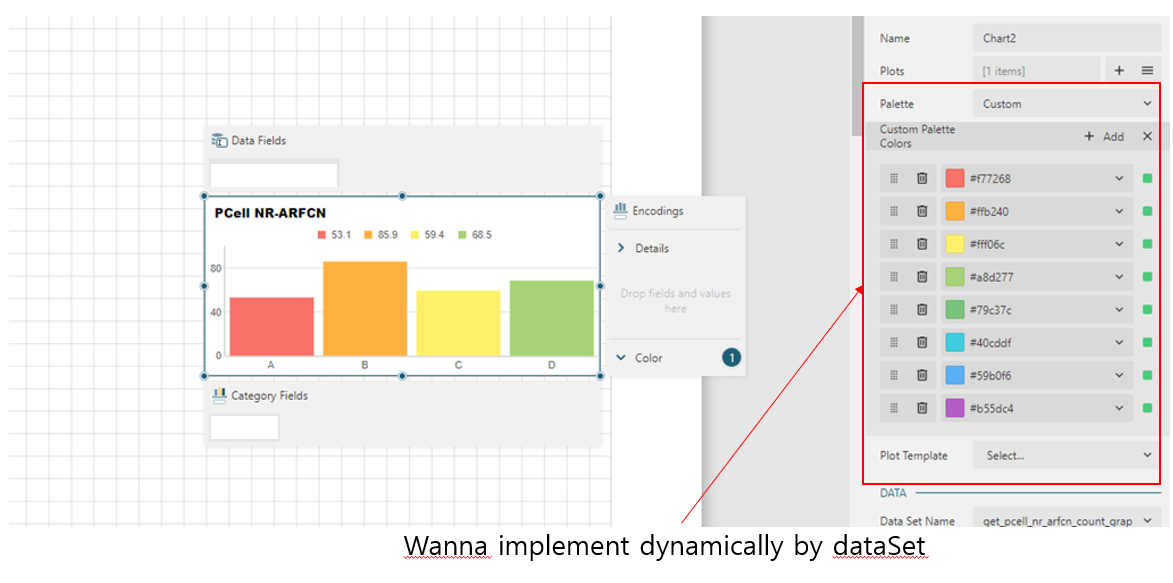

    When designing report chart in ActiveReportJs Designer
    I want to color the chart with the color I want with using hex color list in dataSet.
    Currently, I received the hex color value list in dataSet.
    like ([{map=#ffb240}, {map=#a8d277}, {map=#59b0f6}, …])
    Is there a way to dynamically implement the chart color on custom palette based on the color value of the dataSet?

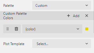

    how can i evaluates list values using expression?
    when i using that list at expression, it only evaluates first list value…
    list : ([{color=#ff0000}, {color=#00ff00}, {color=#0000ff}, …])
    like below image

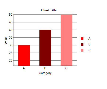

  • Posted 26 July 2021, 8:59 pm EST - Updated 3 October 2022, 8:11 am EST
    It has to be red, blue, and green color…
    but only colored #ff0000 value in this image

  • Posted 27 July 2021, 5:35 am EST
    I see, so you have a separate dataset including color values and you want to map it to a chart palette color.
    There is no built-in functionality that would allow achieving that because a chart palette must contain multiple values, one per color.
    The only workaround I can suggest is to modify a report template programmatically by pulling the color values and setting them for the chart color palette.
