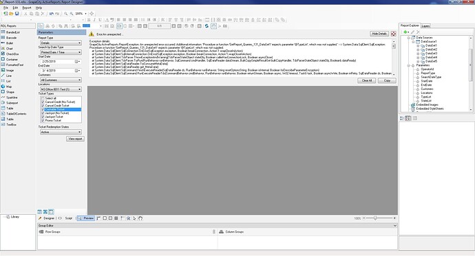

    Having an issue similar to this one:
    https://www.grapecity.com/en/forums/ar-dev/multi-value-parameter-not-
    Was able to take an existing SSRS Report and import it to the Active Reports 13 Report Editor.
    Then modified to use the correct SQL calls.

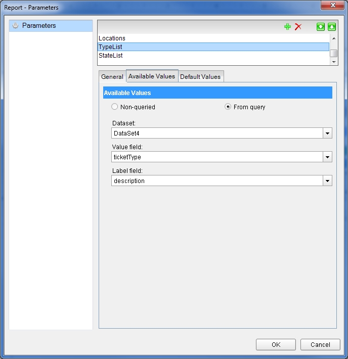

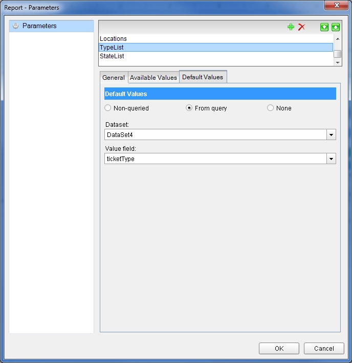

    Next modified the parameters to insure that they are correct.
    Everything imported and the report calls the Reports’ Main SQL Stored Procedure and works properly if I do not use “multivalue” selection on any of the parameters.

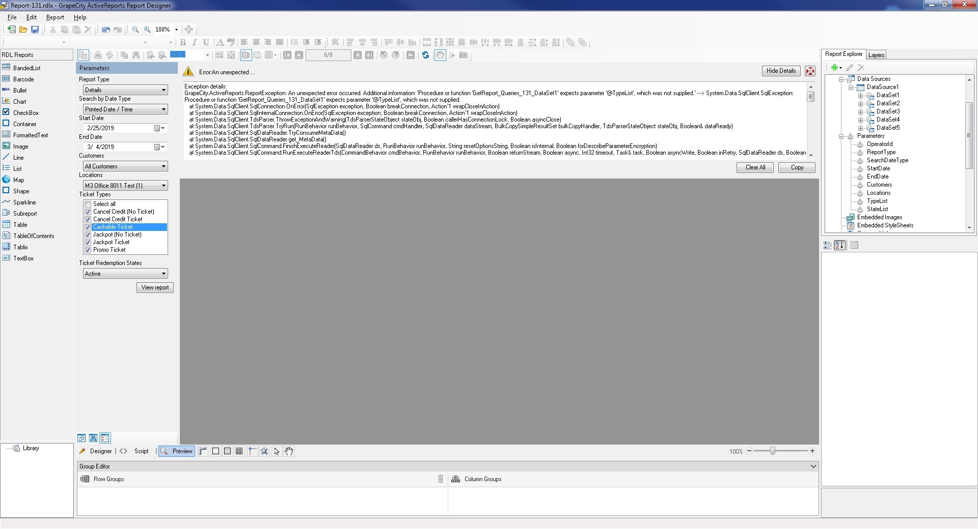

    Note that on the “Issue-5” screenshot below that all of the items in the "Ticket Types are all selected which is the desired result. But the call to the query has the SQL Exception.
    The exception message is shown below when attempting to choose multivalue on ANY of the items that can be used for multiple values.
    Any idea on what to do to fix the issue?
    Bill G.
    Exception details:
    GrapeCity.ActiveReports.ReportException: An unexpected error occurred. Additional information: ‘Procedure or function ‘GetReport_Queries_131_DataSet1’ expects parameter ‘@TypeList’, which was not supplied.’ —> System.Data.SqlClient.SqlException: Procedure or function ‘GetReport_Queries_131_DataSet1’ expects parameter ‘@TypeList’, which was not supplied.

  • Posted 5 March 2019, 2:07 am EST
    In order to achieve your requirement, you need to use JOIN function while passing the parameter in the stored procedure. Please refer the attached report for implementing the same.
    Also, refer to the below-stored procedure which has been used in the report
