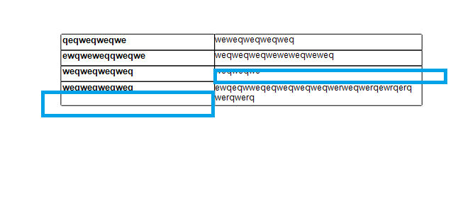

    Could you please confirm, what do you mean by “but with free space below” here. Could you please see the attached image.

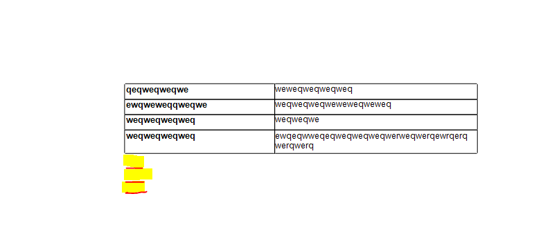

    I meant break lines under table like here:
