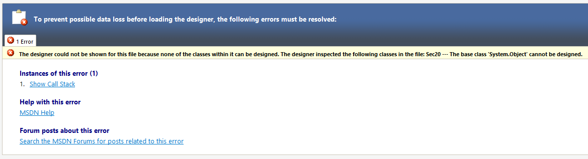

    1. When creating the subreport inside “App_code”, the file by default has the “build action” as “content” and not “compile”. After change it to “compile” I get an error in “design view”
    After calling the “design view” the section report is presented as a class

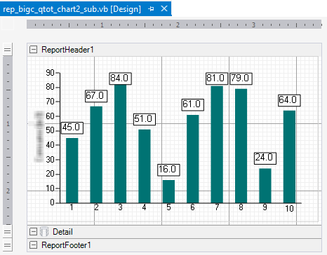

    Fom this picture, “rep_bigc_qtot_chart_sub” it’s a section report created by AR7 and converted to AR13, “rep_bigc_qtot_chart2_sub” was created with AR13.
    The section reports “rep_bigc_qtot_chart2_sub” it’s accessible in design view:
    All my code it’s inside “rep_bigc_qtot_chart2_sub.Designer.vb” and at the end the section report works.
