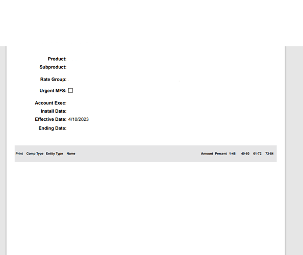

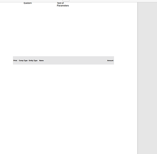

    My generated PDF looks like this even though there are 10 rows of data in the dataset.table[0].
    The first screenshot shows my dataset’s fields. The second shows my report PDF. I had to blank out the top data except the date because it’s sensitive and the top part is populating appropriately from my first datasource that is connected to a Stored Procedure. The Header Row is populating, but the data rows are missing in my table.

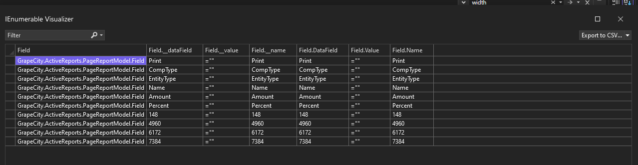

  • Posted 25 April 2023, 4:31 pm EST - Updated 25 April 2023, 4:36 pm EST
    Wanted to add what the _ds looks like in the LocateDataSource code:

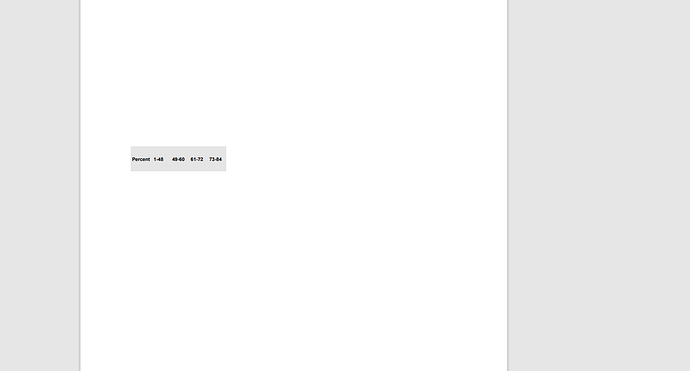

  • Posted 27 April 2023, 4:35 pm EST - Updated 27 April 2023, 4:41 pm EST
    Here’s what I’m getting from this sample project.

  • Posted 2 May 2023, 1:04 am EST
    Hi Melissa,
    In your sample, we could observe that you have not specified any height for your ‘trData’ row due to which it takes ‘0in’ as its height by default and therefore does not appear to render any row in the report preview.
    Updating the code to specify a height to ‘trData’ as
    trData.Height = "0.7cm";
    fixes the issue.
