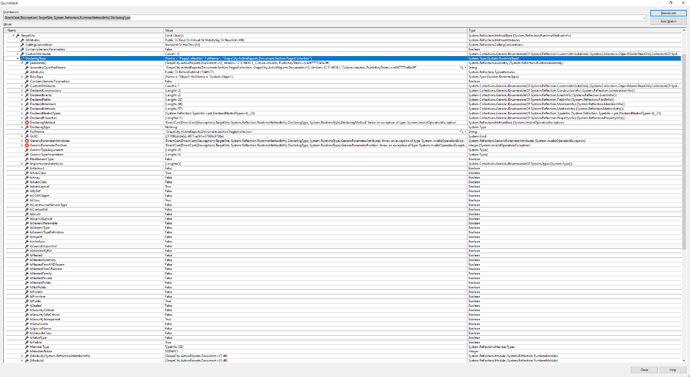

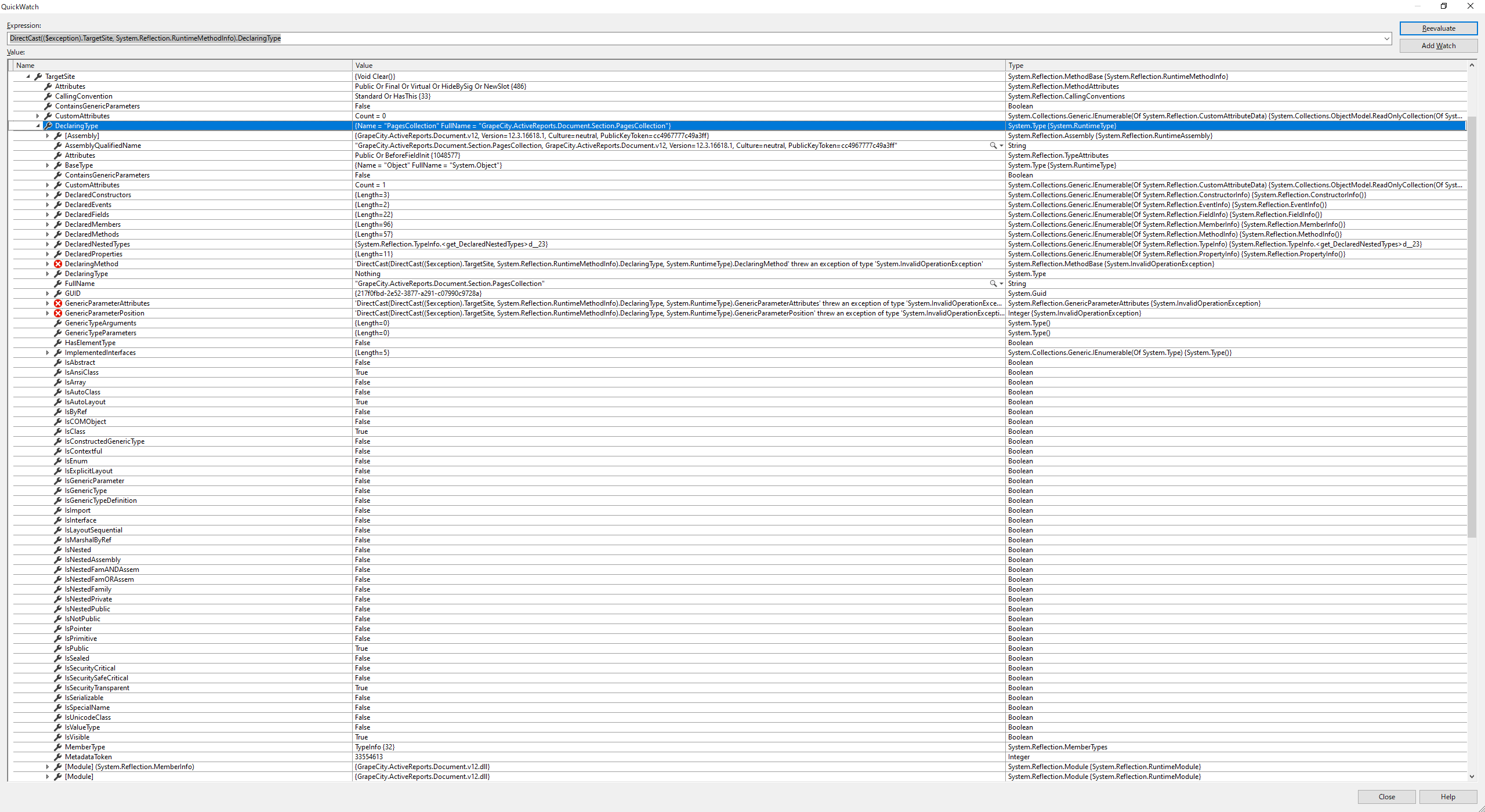

  • Posted 30 July 2019, 10:39 pm EST - Updated 30 September 2022, 5:39 pm EST
    I think maybe error around pagescollection, but I can’t find where using it :frowning:
