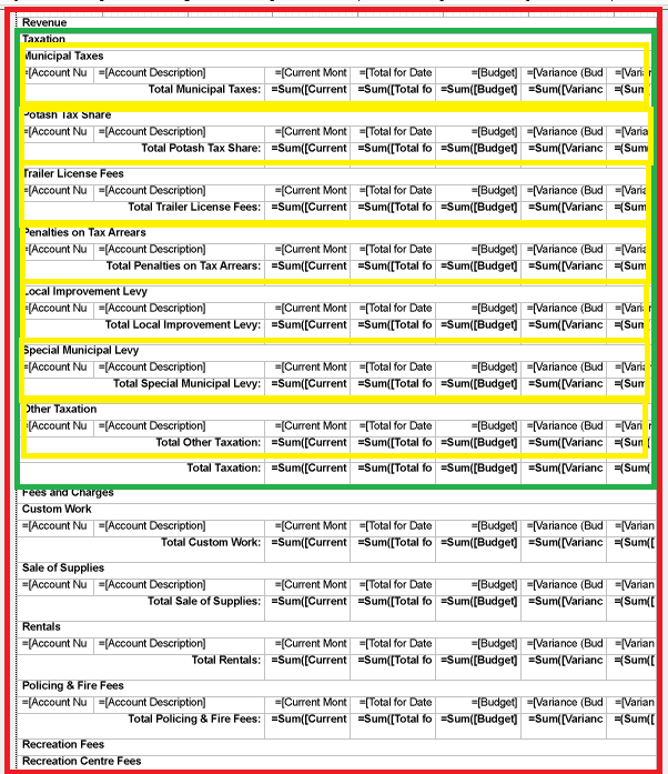

    For example, here is the report structure showing the nested tables:
    The red section is the “outer most” table. It has two rows with two large “level 1” sections, the first outlined in green. Each “level 1” table has multiple rows each containing “level 2” tables, outlined in yellow (for the first table). Each of the Yellow tables filters any “all 0” records, with each row in teh “green” table filtering out the whole table if it empty (all rows are 0). All the yellow (level 2) tables move up to fill any gaps, and the footer of the “green” table moves up as well. What doesn’t move up is the next “green” (level 1) table.
    The row height for the row for the “red” table that contains the entire “green” table doesn’t change. Inspecting the properties I see that the internal “CanShrink” property of that row is False even though all TextBoxes on all reports have their CanShrink property set to True.
    Is there a way to get that row to shrink so that the next row at the same level?

    There could be various reasons why the space was not shrunk down when the visibility of the TextBoxes is set to false.
    However, what we suspect the issue here may be is that the TextBoxes are hidden, but the row is still being visible, causing a blank row to render.
    To fix this, you can try assigning the same Visibility.Hidden condition in the row. And as the Row itself cannot shrink (it has a fixed size) you can manually reduce its height to the lowest value it can be shrunken down to and keep the ‘CanGrow’ property of the TextBoxes contained within it to ‘True’.
    This way, when the Cells are hidden, the Row will take up the minimum height we specified, and when the Row Cells are visible, it will automatically grow to take up the required height.
    If the issue persists, please try sharing a sample that replicates the issue so we can test the issue on our end and further investigate the same.
