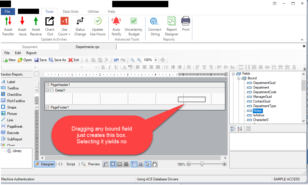

    I spent a day creating a custom End User Designer based on the sample End User Designer for v13. Everything works fine except I cannot drag a bound field from the Report Explorer onto the Designer when in Section Reports; I haven’t tried the page/rdl. All I get is a square box that appears to be a “nothing”. There’s nothing to it. I know I did something wrong because the sample project works fine and my v12 code works fine (although very different from v13). I spent the last 5 hours going over everything comparing properties and script between projects and then commenting out script I added but I haven’t come up with anything. Before I spend another day re-creating my custom End User Designer, has anyone seen this before?

    There must be a problem in the code that’s why you faces this issue. Also, it is difficult to narrow down the issue without looking at the actual sample. Is it possible that you can send the running sample to me so that I can replicate the issue at my end and assist you accordingly?
