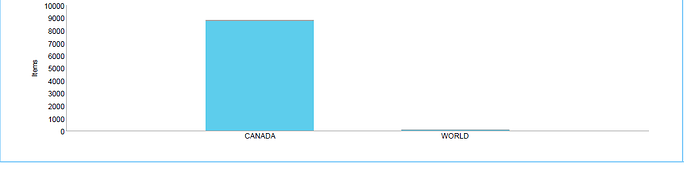

    I have a report with 2 charts (stacked bars)
    The x axis labels are text from a field and the length of the text varies.

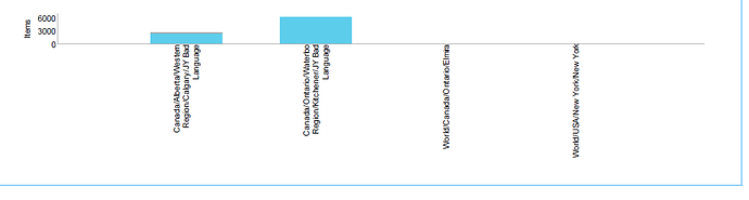

    When I have text that is very long, the labels go vertical (which is fine) however the chart then shrinks down to accommodate the label.
    I have put a page break after each to allow the chart to have a full page (landscape) but it still occurs.
    Ideas?

    Its the by design behavior. Chart always render in its defined area. It cannot increase its size according to the value. You can try after changing the label position to “Horizontal” instead of “Auto”.
