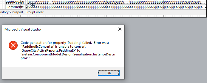

    We are getting the following error after upgrading our project to Active Reports 15:
    “Code generation for property ‘Padding’ failed.”
    This happens with several different reports.

    Can you please share the dummy sample with me so that I can replicate the issue at my end.
