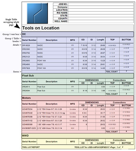

    Does anyone know how to create a table that contains a single group which can be repeated as needed, depending on if there is data to fill those groups or not?
    I have attached a mockup of what I’m talking about. There is a single table, and within the table is a group that has a textbox for a label, then a table with header, details and footer. Once that group is filled, another group is started, formatted the same way but from a different dataset. And then another group, then another.
    Is there a way for me to make a single group in AR, and have that group be duplicated as needed?

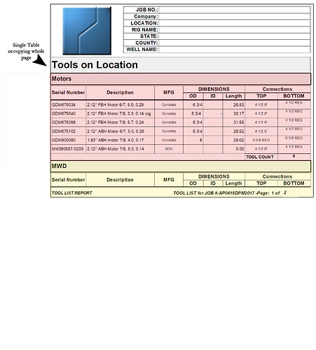

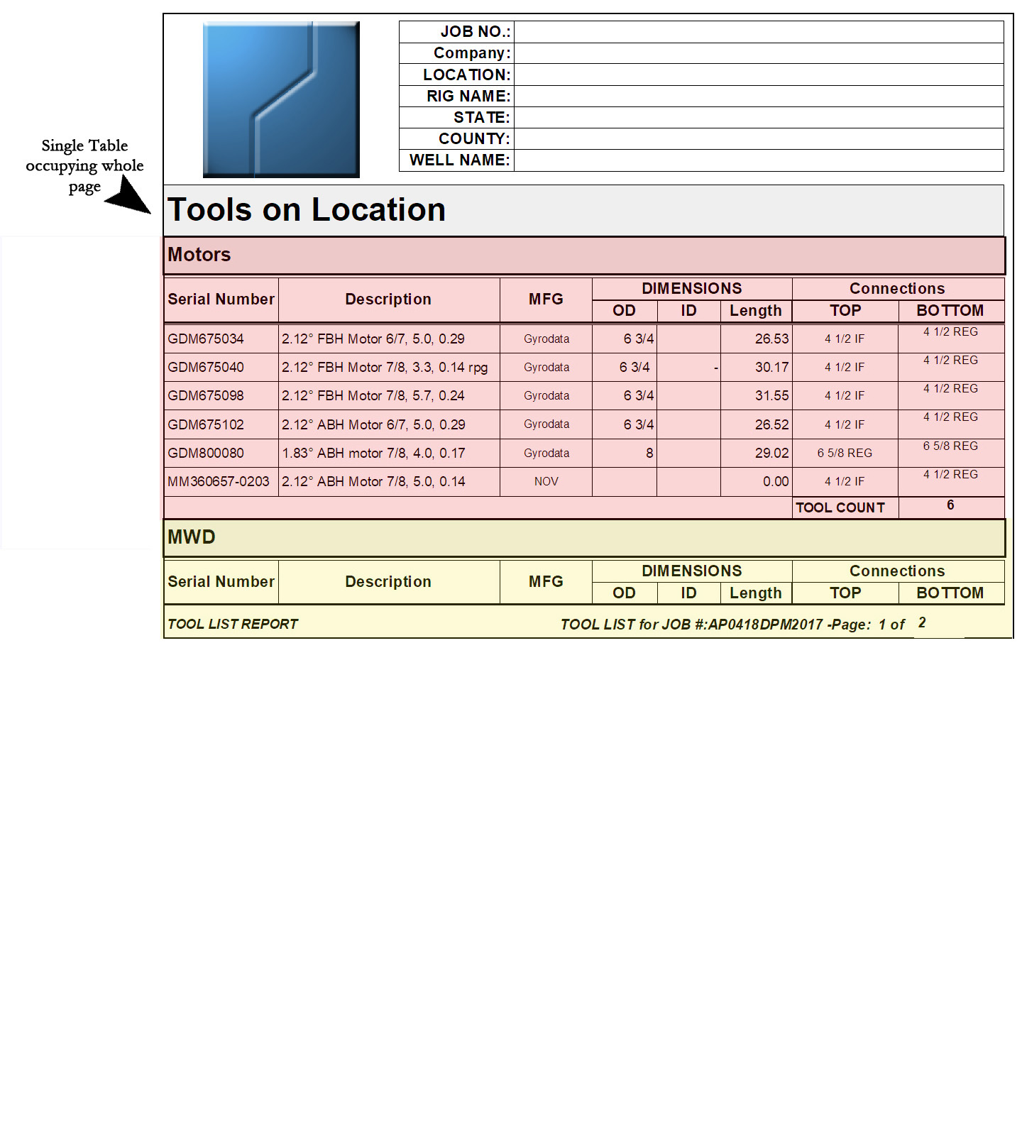

    I would like to duplicate the format of the group, but have different labels. The requirement that I’m going for is depicted in the screenshot. The screenshot shows a group that has “DC” along with a table and footer, then another group that is labeled as “Float Sub” with its own table, then one for motors, and then one for MWD.
  • Posted 14 May 2018, 12:44 pm EST - Updated 30 September 2022, 6:18 pm EST
    Another example. In this screenshot, there is only data for Motors and MWDs, so the other groups are not generated, and the relevant data is displayed.
