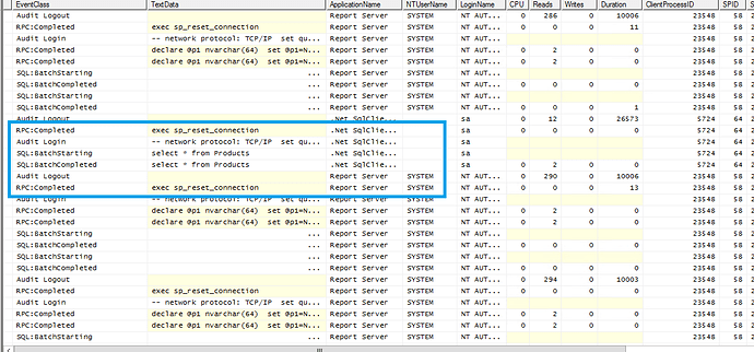

    This is not something that used to occur but we just noticed recently in both AR11 and AR12.
    If a field from a dataset is used in a aggregate function the dataset is executed twice. This causes extra load on the server but even worse if the query modifies data it can cause undesirable results.
    It seem it is executed first on the thread that calls execute and as part of the rendering extension it is executed a second time on a background thread.
    If the field is just bound say in a table the dataset only executes once as expected.
    I have a attached a test rdlx that reproduces the issue, it calls waitfor in Sql server to simulate a long running query, its set for 5 seconds but the report will take 10 seconds to execute due to two executes. You can watch sql serve profiler to see two separate calls from the client for the exact same sql statement.

    Updated to 13124 same issue. My test just has a textbox in the body using the First aggregate function to get the value from the dataset:

  • Posted 17 May 2018, 10:26 am EST
    Thanks for the information.
    I am able to replicate the problem at our end. I have escalated this to the development team(Tracking ID 258397) and will revert you back once have any information from them.
