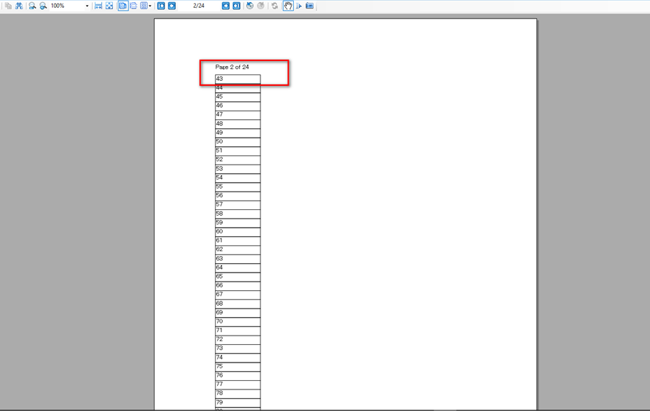

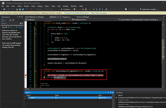

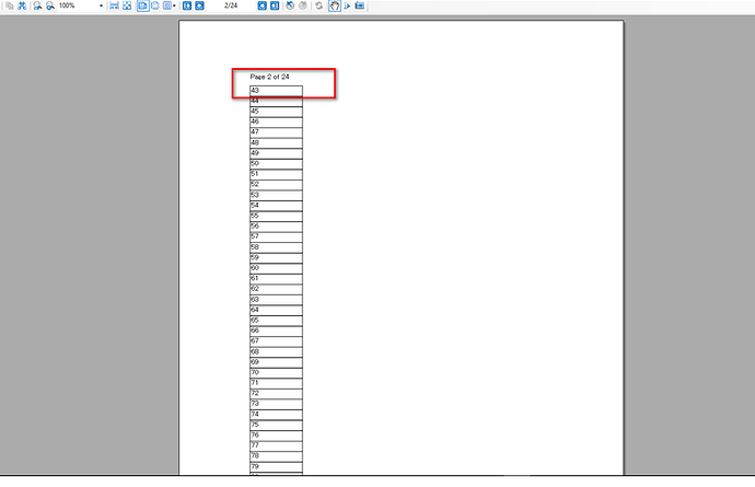

    Why value of the rows number in details of section report when debug at event PageStart is 44 rows/page but when show on preview is 43 rows/page
    Number of rows when debug:
    Number of rows when show on preview:

    It is by design behaviour. As per documentation, section’s height is unknown until the Format event finishes, it is possible for a section’s Format event to be raised while the report is on a page to which the section is not rendered. For example, the Detail Format event is raised but the section is too large to fit on the page. This causes the PageFooter events and the PageEnd event to be raised on the current page, and the PageStart, any other Header events, and possibly the FetchData event to be raised before the section is rendered to the canvas on the next page. Please refer the following link:
    http://help.grapecity.com/activereports/webhelp/AR12/webframe.html#ReportEvents.html
    However, I have modified the sample to achieve your requirement. Please refer the attached sample.
    Hope it helps.
