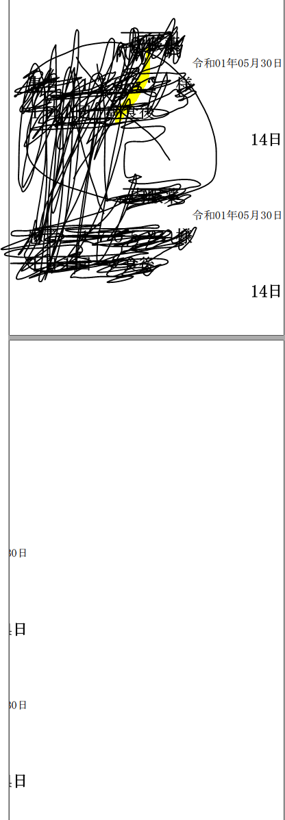

    Hi, i’m trying upgrade AR3 => AR12
    My layout is ok on AR3, but in AR12, some layout was duplicate the last character to new page ( I don’t know how to description, please check image )
    Please help me
  • Posted 20 June 2019, 8:05 am EST
    Hello Vuong,
    It is difficult for me to provide a solution without looking at the Report Layout. Could you please share the report layout with us so that I can assist you accordingly.
    However, you can try after setting the “KeepTogether” property of “Detail” secton to “True”.
  • Posted 20 June 2019, 11:31 pm EST
    thank you very much @mohitg
