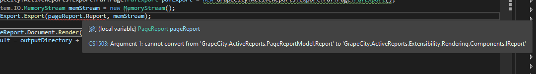

    //so tried this but this fails because of the screenshot included
     GrapeCity.ActiveReports.Export.Pdf.Page.PdfExport pdfExport = new GrapeCity.ActiveReports.Export.Pdf.Page.PdfExport();
    System.IO.MemoryStream memStream = new MemoryStream();
    pdfExport.Export(pageReport.Report, memStream);
