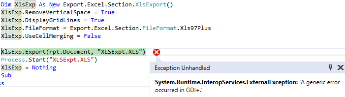

    I use the last version of AR 12.1 for export SectionReport with picture inside to Excel.
    XLSExport crashes.
    Sample attached.SectionReportApplication2.zip

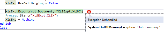

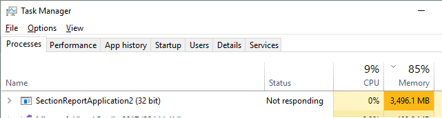

  • Posted 27 June 2018, 9:31 am EST
    After install 12.1.13655.0 it still crashes. I modified records count to 2000 in my sample.

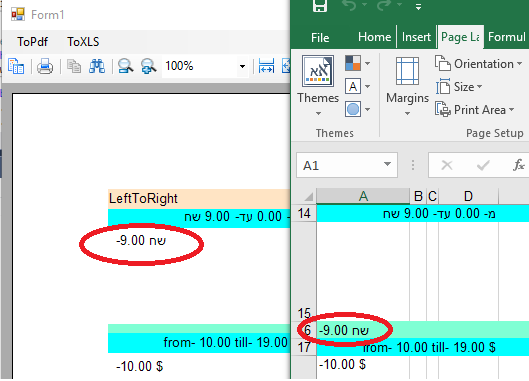

  • Posted 3 July 2018, 1:09 am EST - Updated 30 September 2022, 6:11 pm EST
    After installing hotfix the export crash fixed.
    Excel export output appears garbled in my sample.

  • Posted 5 July 2018, 2:40 pm EST - Updated 30 September 2022, 6:11 pm EST
    After installing hotfix the issue fixed.
    Excel export output appears garbled in my modified sample.

  • Posted 11 July 2018, 10:43 am EST
    Hello Ilia,
    This is the design behavior of XLsExport. XlsExport is not WYSIWYG. If you want WYSIWYG, you need to use the Page/RDL report with Excel RE.

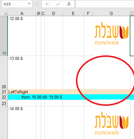

  • Posted 12 July 2018, 2:03 am EST
    First, I did not ask to export WYSIWYG.
    Secondly, in this case the picture disappears. It seems, you render the picture in clip mode instead of stretch mode.
