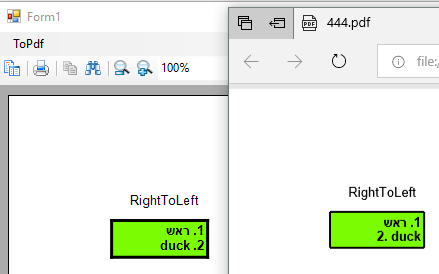

    I use Hebrew language in my section report. I some cases I need to set TextBox.RightToLeft True. When text contains mixed text this works well in the Viewer, but does not when Export to Pdf (the second line of text renders LeftToRight instead of RightToLeft).
    Example attached. SectionReportApplication2.zip

    I am able to replicate the problem at our end. I have escalated this to the development team(260230) and will revert you back once have any information from them.
