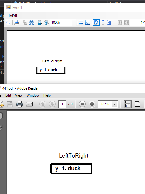

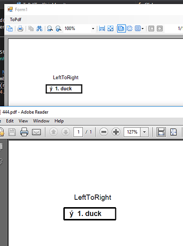

    I run the attached sample, however, I get the same result in viewer and PDF export. Please refer the attached image.

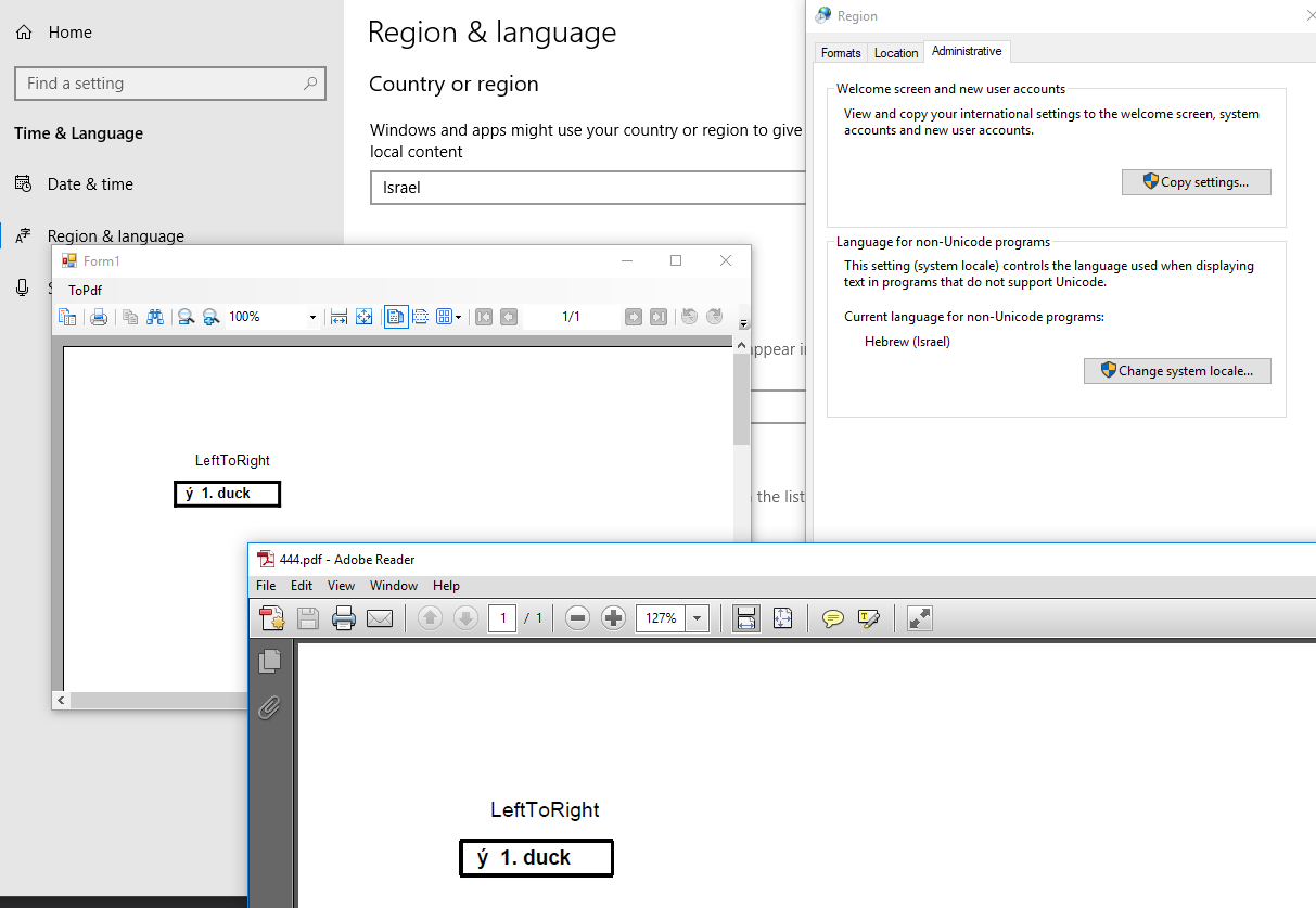

  • Posted 3 July 2018, 6:19 am EST - Updated 30 September 2022, 6:13 pm EST
    Same result appears after changing the “current language for Non-Unicode programs” to “Hebrew”. Please refer the attached image.
