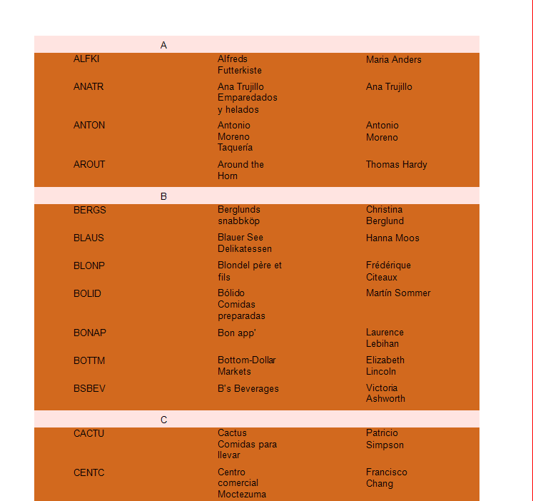

    Hi. I have been asked to create a list a persons grouped by first letter. So all the A’s would be under A, etc. I have a feeling that this can be done, I just can’t quite figure out how to do it.
  • Posted 28 February 2019, 6:58 am EST
    To achieve your requirement, you can store the required data in a DataTable where one column contains the initials of the names of the people. This can be obtained using the Substring method of a string.
    A report layout is created such that the report is grouped based on the DataField with initials of the names.
    Further, data from the DataTable can be sorted using a View and then used as a DataSource to the report. This is done as follows:

  • Posted 28 February 2019, 6:12 pm EST
    Hi, thanks your your reply. I was hoping there would be a way to do it with some kid of calculation. Like getting the initial directly from field value in the report viewer and then grouping on the results.
  • Posted 1 March 2019, 10:39 am EST
    You can create a “Calculated Field” with Formula “FieldName.Substring(0, 1)”. After that use the calculated field in “DataField” property of the Group. Please refer to the attached report.

  • Posted 4 March 2019, 5:38 pm EST
    Hi. I tried adding a calculated field, and then grouping by that field. I also put the calculated field in the group header. Problem is it sisn’t work. It didn’t group, and the calculated field in the header was blank. Below is the xml. what am I doing wrong?
    <?xml version="1.0" encoding="UTF-8"?>
  • Posted 5 March 2019, 1:51 am EST
    Have you bound the report with any datasource? Because the “DataSource” part is missing in the above XML file. You have to bind the report with datasource to use the datafield. Also, please sort your SQL query according to “Name” field like below to use for grouping in the section report:
    Select * from Table Order by Name
