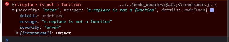

    I have angular application, it generates data at runtime and I want to show this data using ar-viewer package. I am using viewer.openReport(data) method, but I am getting next error:
    data is rdlx-json file.
  • Posted 22 September 2021, 1:00 am EST
    Report is generated using the ARJS cannot be open using AR15. You need to open it using ARJS only.
