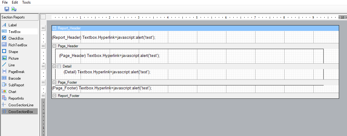

    Can someone tell me why the hyperlink is not working within a CrossSectionBox when running the report in the HTML Viewer.
    Hyperlink work well outside of the CrossSectionBox but not inside.
    It very easy to reproduce the issue. Just add textboxes with hyperlink in each section (Report_Header, Page_Header, Detail, Page_Footer) then make tests by adding or removing the CrossSectionBox between Page_Header and Page_Footer section.
    See attached image.

    I am able to reproduce the issue at my end. I have escalated this to our developer team(Tracking Id 258230) and will inform you once I get any information from them.

    You could also use the “CrossSectionLine” instead of “CrossSectionBox” as a workaround as of now.

    This issue is fixed in our internal build. It will come with our next release AR12 SP2(August 2018). Could you please tell if you need hotfix for the same.
