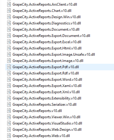

    We are getting the error “License for the WebViewer cannot be found” when deploying the application on Window Server 2012 R2 but it working fine on the developer machine.
    See the attached screenshot which shows dll we used in our application and error message that we are getting.

    Please add the following license entries in “Licenses.licx” file
    GrapeCity.ActiveReports.Web.WebViewer, GrapeCity.ActiveReports.Web.v10
    GrapeCity.ActiveReports.SectionReport, GrapeCity.ActiveReports.v10
    GrapeCity.ActiveReports.PageReport, GrapeCity.ActiveReports.v10
    GrapeCity.ActiveReports.Export.Pdf.Section.PdfExport, GrapeCity.ActiveReports.Export.Pdf.v10
    Hope it solves your issue.
