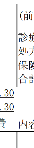

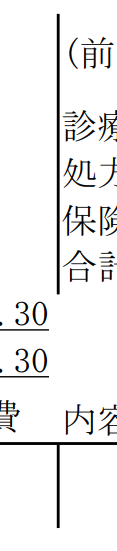

    Hi, I’m upgrade AR3 => AR12 and have a problem. In AR3 have a full line, but AR12 is not. My layout is: left layout | right layout ( the line between 2 layout)
    Previous is Y1: 0, Y2: 0,5. I already change Y2 to 1 but it still same, cannot taller
    Please help

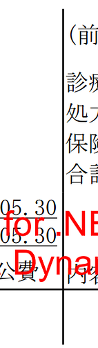

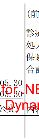

  • Posted 28 June 2019, 4:46 am EST
    look like AnchorBottom not work in AR12
    In AR3 height is 0 and AnchorBottom = True
    In AR12 need set height of line manually, no need AnchorBottom
  • Posted 1 July 2019, 7:07 am EST
    Yes, I am able to reproduce the issue with the “0” height. Please check after setting the “Y2” to “0.01” as a workaround.
