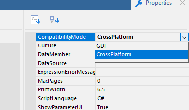

    To run your SectionReport in a Linux environment you’ll need to change its ‘CompatabilityMode’ to ‘CrossPlatform’ as GDI is only supported in the Windows platform.

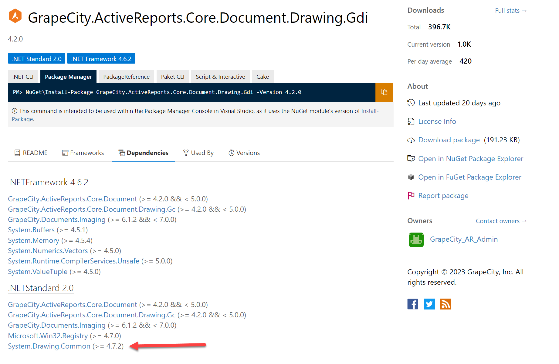

    The section reports are set to CrossPlatform. The root issue is the nuget package https://www.nuget.org/packages/GrapeCity.ActiveReports.Core.Document.Drawing.Gdi is referencing System.Drawing.Common. The reference was added in the 4.x release.
    The 3.x version of the library does not have this reference.
    https://www.nuget.org/packages/GrapeCity.ActiveReports.Core.Document.Drawing.Gdi/3.6.3#dependencies-body-tab

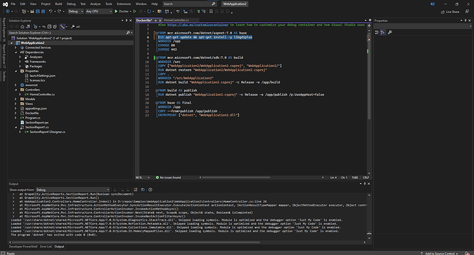

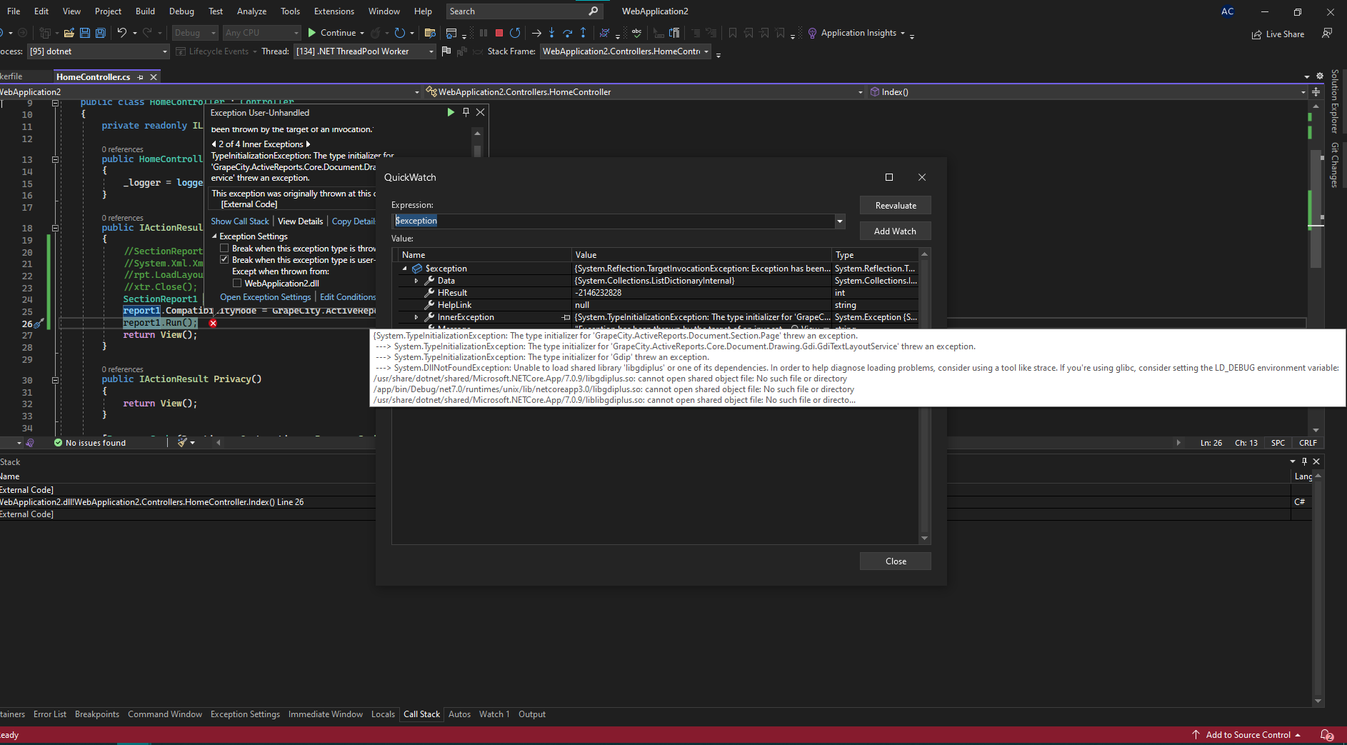

    We tried to replicate the issue by running an ActiveReports 17 - SectionReport application (NET 7) in a Linux Docker Container and got the same error you are getting (see image)
    However, installing ‘libgdiplus’ in our Linux container seems to fix the issue.
    Please make sure you install libgdiplus in your Docker Linux Container.
    Your Dockerfile should look like this:
    FROM mcr.microsoft.com/dotnet/core/aspnet:7.0 AS base
    RUN apt-get update && apt-get install -y libgdiplus
    WORKDIR /app
    FROM mcr.microsoft.com/dotnet/core/sdk:7.0 AS build
    Anand
