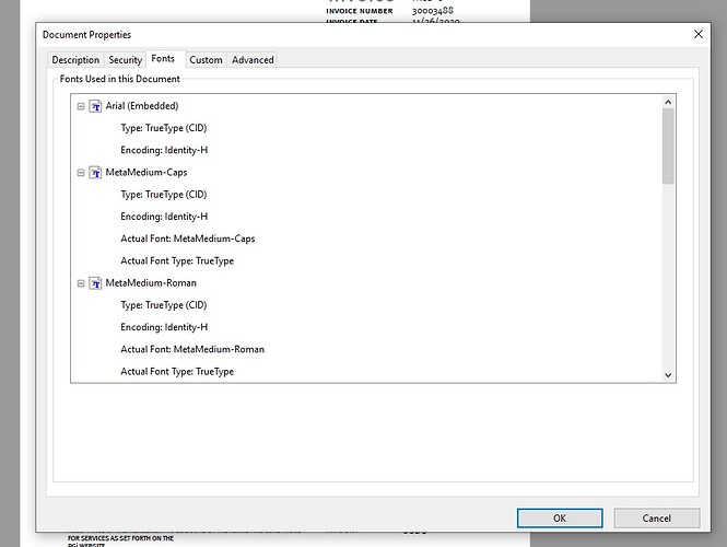

    I’m converting a template from Crystal Reports to Active Reports rdlx template
    The original template uses Meta fonts - e.g. https://en.wikipedia.org/wiki/FF_Meta

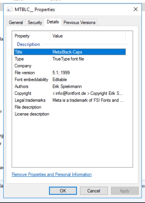

    The fonts have font embeddability option of Editable (see screen shot 1)
    We are generating the PDFs using all property of FontEmbedding property as below
    var pdfSettings = new Settings()
    EmbedFonts = FontEmbedding.All,
    Version = PdfVersion.Pdf17,
    Use128Bit = true,
    Application = “Edge”,
    Author = “Edge”,
    DisplayMode = DisplayMode.None

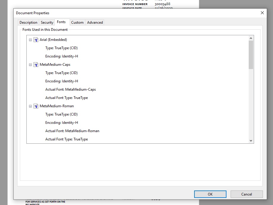

    Yet when the PDFs are generated the meta fonts are not embedded (all other fonts are) . See attached for generated PDF properties
    Are Meta fonts supported by Active Reports for purpose of embedding?

    also attaching a sample PDF as the embedded fonts are different (i.e. not attached to font META - which does seem to embed - but to specific fonts within the family)sample-for-grapecity.zip

    Thanks for the font. I am able to reproduce the issue and have escalated the issue to the development team(AR-25968). I will inform you once I get any information from them.
  • Posted 1 March 2021, 11:20 am EST
    Sorry to mention that it is limitation of the PDFExport.
