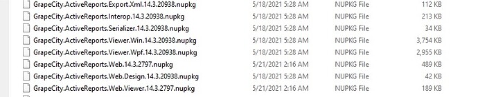

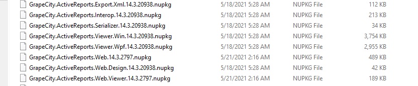

  • Posted 21 June 2021, 3:00 pm EST - Updated 30 September 2022, 4:38 pm EST
    All the entries in the NuGet folder have Version 14.3.20938, however the ActiveReports.Web and ActiveReports.WebViewer are Version 14.3.2797. Is it correct?
    Also, I can’t find ActiveReports.ReportService.
  • Posted 21 June 2021, 3:08 pm EST
    Is it correct?
    Yes.
    There is no ActiveReports.ReportService dll in AR14.

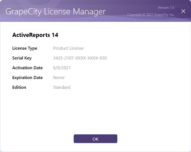

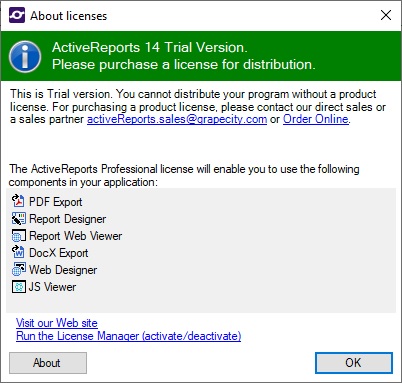

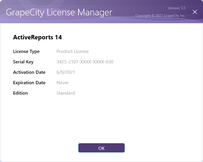

    Hello!
    Can you explain/help me with the AR licensing.
    I had a version 14.0.19484 but it was not working right. You sent me a fix, AR Version 14.3.20938.0 msi.
    This one works fine, I can create any report, but the licensing gives me a problem. I attached the images of my License Manager and the error.
    The License Manager displays that the license never expires and the error displays that it’s a trial version.
  • Posted 29 June 2021, 3:13 pm EST
    You have standard license but you are trying to use the feature which only available in the professional license that’s why you are facing this issue. Please refer to the following link:
