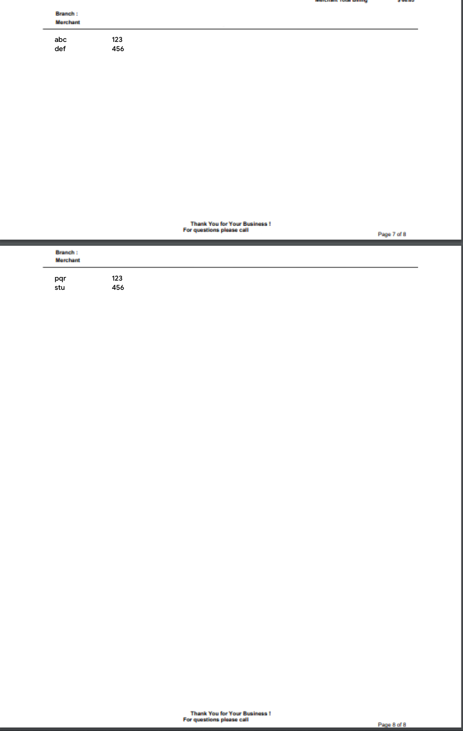

    I am working on a report which calls a subreport internally.
    The call is being made in detail_format() method. I want to add 2 text boxes only at the last page of the report. We have set a counter to get number of rows from subreport and when the counter ==0 print the textboxes.
    Issue is even though counter is 0, and if data doesn’t fit in the current page…it prints another page and I am not able to get total number of page count. That is the reason my two text boxes are being printed twice.
    Also, I am not able to trigger reportend() method.

  • Posted 25 November 2019, 12:44 pm EST - Updated 30 September 2022, 5:26 pm EST
    So this is a sample of what the report looks like. Even though there is enough page on second last page, new record is printed on the last page and footer is printed twice.

  • Posted 26 November 2019, 3:37 am EST
    ReportEnd method renders fine, in general. Could you please add a breakpoint and see if the rendering happens (using some MessageBox within the method)?
    As per the layout, it appears that you have used the textbox fields in the Detail section of the subreport. Please place them in the ReportFooter (that renders once at the end of the report) to meet your requirement.
