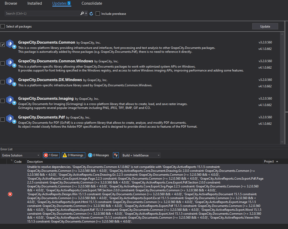

    I am in the process of upgrading some reports from v14.x to v15.1.5. In Nuget, I show 5 packages that won’t update - GrapecCity.Documents.Common, GrapecCity.Documents.Common.Winodws, GrapeCity.Documents.DX.Windows, GrapeCity.Documents.Imaging, and GrapeCity.Documents.PDF. They are stuck on v3.2.0.560. When I try to upgrade them to 4.1.0.662, I get the following message…
    Severity Code Description Project File Line Suppression State
    Error Unable to resolve dependencies. ‘GrapeCity.Documents.Common 4.1.0.662’ is not compatible with ‘GrapeCity.ActiveReports 15.1.5 constraint: GrapeCity.Documents.Common (>= 3.2.0.560 && < 4.0.0)’, ‘GrapeCity.ActiveReports.Core.Document.Drawing.Gc 2.0.0 constraint: GrapeCity.Documents.Common (>= 3.2.0.560 && < 4.0.0)’, ‘GrapeCity.ActiveReports.Core.Drawing.Gc 2.2.5 constraint: GrapeCity.Documents.Common (>= 3.2.0.560 && < 4.0.0)’, ‘GrapeCity.ActiveReports.Core.Export.Image.Page 2.2.5 constraint: GrapeCity.Documents.Common (>= 3.2.0.560 && < 4.0.0)’, ‘GrapeCity.ActiveReports.Core.Export.Pdf.Page 2.2.5 constraint: GrapeCity.Documents.Common (>= 3.2.0.560 && < 4.0.0)’, ‘GrapeCity.ActiveReports.Core.Export.Pdf.Section 2.0.0 constraint: GrapeCity.Documents.Common (>= 3.2.0.560 && < 4.0.0)’, ‘GrapeCity.ActiveReports.Core.Export.Svg.Page 2.2.5 constraint: GrapeCity.Documents.Common (>= 3.2.0.560 && < 4.0.0)’, ‘GrapeCity.ActiveReports.Core.Export.Tiff.Section 2.0.0 constraint: GrapeCity.Documents.Common (>= 3.2.0.560 && < 4.0.0)’, ‘GrapeCity.ActiveReports.Design.Win 15.1.5 constraint: GrapeCity.Documents.Common (>= 3.2.0.560 && < 4.0.0)’, ‘GrapeCity.ActiveReports.Document 15.1.5 constraint: GrapeCity.Documents.Common (>= 3.2.0.560 && < 4.0.0)’, ‘GrapeCity.ActiveReports.Export.Excel 15.1.5 constraint: GrapeCity.Documents.Common (>= 3.2.0.560 && < 4.0.0)’, ‘GrapeCity.ActiveReports.Export.Html 15.1.5 constraint: GrapeCity.Documents.Common (>= 3.2.0.560 && < 4.0.0)’, ‘GrapeCity.ActiveReports.Export.Image 15.1.5 constraint: GrapeCity.Documents.Common (>= 3.2.0.560 && < 4.0.0)’, ‘GrapeCity.ActiveReports.Export.Pdf 15.1.5 constraint: GrapeCity.Documents.Common (>= 3.2.0.560 && < 4.0.0)’, ‘GrapeCity.ActiveReports.Export.Rdf 15.1.5 constraint: GrapeCity.Documents.Common (>= 3.2.0.560 && < 4.0.0)’, ‘GrapeCity.ActiveReports.Export.Word 15.1.5 constraint: GrapeCity.Documents.Common (>= 3.2.0.560 && < 4.0.0)’, ‘GrapeCity.ActiveReports.Export.Xml 15.1.5 constraint: GrapeCity.Documents.Common (>= 3.2.0.560 && < 4.0.0)’, ‘GrapeCity.ActiveReports.Viewer.Common 15.1.5 constraint: GrapeCity.Documents.Common (>= 3.2.0.560 && < 4.0.0)’, ‘GrapeCity.ActiveReports.Viewer.Win 15.1.5 constraint: GrapeCity.Documents.Common (>= 3.2.0.560 && < 4.0.0)’.
    This is a .NET framework project - not Core. Can I just ignore these updates? Just bugs my OCD when I see them sitting out there.

    Version 4.* of “Grapecity.Document.*” is not compatible with AR15 that’s why you are receiving the error message.
    Please update the ActiveReports related package only not the dependency packages. Actually, the latest version of the dependency packages is not compatible with ActiveReports current version that’s why we don’t suggest to upgrade them manually.
    Hope it clarifies.
