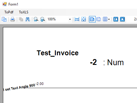

    Hello Ilia,
    Please set the TextAngle in “PageStart” event instead of “ReportEnd” event. I have modified the sample.

  • Posted 23 July 2018, 2:51 am EST
    In my sample Page.TextAngle returns -90 instead of 900. Is it by-Design?
  • Posted 23 July 2018, 4:21 am EST
    Hello Ilia,
    I understand, it rotates the text in the different direction. However, as a workaround, you can use “-” sign to rotate it in the right direction.
    Please confirm above workaround is acceptable to you?
  • Posted 23 July 2018, 7:35 am EST
    It not only rotates the text in the other direction, but also returns the angle value 10 times less.
