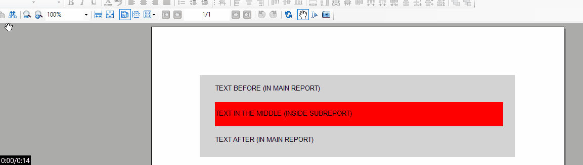

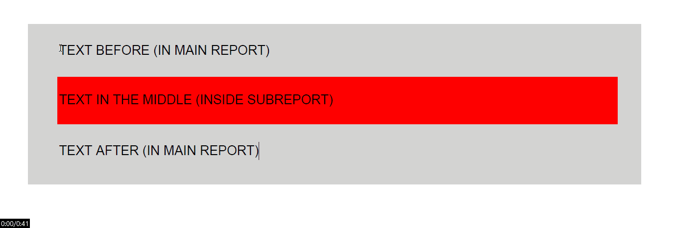

    Please see attached SimpleReportWithSubReport.rpx, SimpleReportWithSubReport.pdf (report exported to pdf) and SimpleReportWithSubReportPdfSecection.gif (video showing how selection in PDF behaves).
    SimpleReportWithSubReport contains only two TextBoxes and a subreport between them (subreport contains the third Textbox).
    After the report is merged and exported to PDF…
    1. It is impossible to select the text by natural way (from top to bottom). Selection behaves in a strange way.
    2. If you copy all the text and paste it into notepad - the texts sequence is incorrect:
      TEXT BEFORE (IN MAIN REPORT)
      TEXT AFTER (IN MAIN REPORT)
      TEXT IN THE MIDDLE (INSIDE SUBREPORT)
      instead of the correct sequence:
    3. If you use screen/text reader for the PDF, it is read out loud incorrectly so such a PDF cannot be used by end-user with visual disabilities.
    How can we achieve the correct/natural order of elements/texts for exported PDFs?
    Thank you

    If this is the root cause: “exported document renders the objects in the same hierarchy as they are in the rendered report or the report document itself”, then it looks like this is NOT working as it should. No matter how internal contents of the report are managed… At the end, the document MUST be filled from top to bottom to allow successful/correct export. See also attached gif, that shows another functionality that does NOT work correctly - searching inside the merged (RDF) report - because of incorrect fields sequence.
    Either the sequence of elements in RDF should be corrected or these functionalities - “Search” and “Export to PDF” - must be corrected, so they work correctly ( irrespective of the elements sequence).
