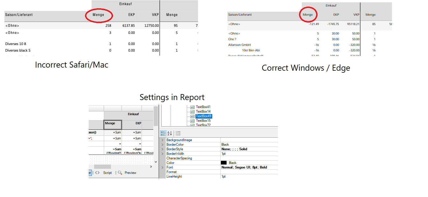

    We have a report with an embedded font (Segoe UI).
    On Windows based machines, the PDF opens with the correct font. With safari/mac another font is shown.
    See attached file for example.

    I have news on this. I could get it to work on PDF download with this line of code:
    var pdfSetting = new GrapeCity.ActiveReports.Export.Pdf.Page.Settings();
    pdfSetting.EmbedFonts = FontEmbedding.All;
    But now I have the problem, that when I open a report file directly like this:
    /Report.rdlx?OutputFormat=pdf, the fonts are not embedded.
    Is there a way to generally embed fonts or to specifiy to embed fonts like /Report.rdlx?OutputFormat=pdf&embedFonts=true
