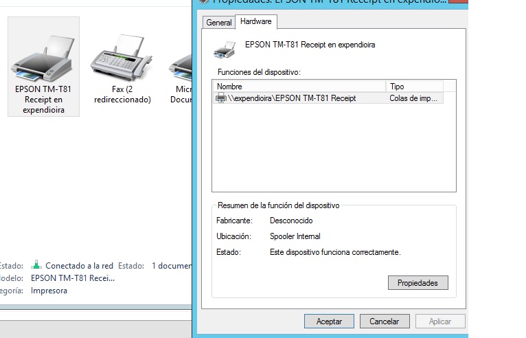

    attached image of the remote printer registered in the IIS server

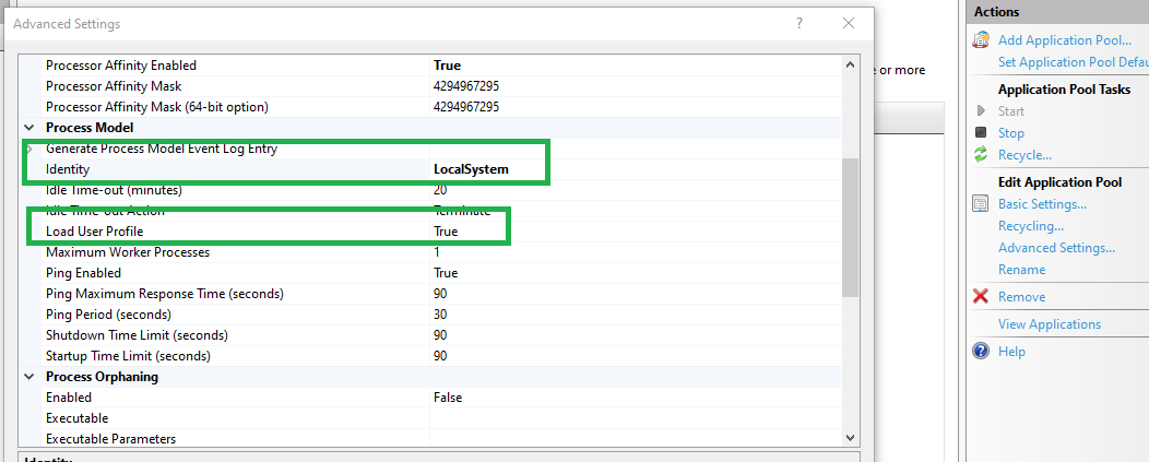

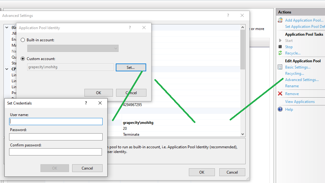

    I think it is a permission related issue. Have you connected the printer with the domain user?
    If yes, please configure your Application Pool Identity to a custom/domain user which has access/permission to print in network printers. Also, set the “LoadUserProfile” setting of Application pool to true.

  • Posted 19 June 2020, 5:52 am EST - Updated 30 September 2022, 5:08 pm EST
    You can try with both settings as shown in the attached images.
