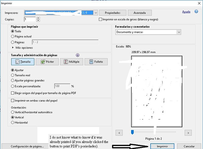

    I use Active Reports 11 and I need to generate and report that it can be sent to print (physically) only one occasion. Is it possible to know if a PDF document was printed?
    Obviously if the document is not printed due to lack of paper in the printer, etc. That does not matter, but I do need to know when I pressed the “Print” button in the PDF options.

    We generate a report that due to security issues, the user is allowed to print one time. The user of the system can view it in PDF as many times as necessary, but you can only print it once. I know how to know if the report was generated in PDF, but I do not know what to know if it was already printed (if you already clicked the button to print the PDF’s poriedades).

    It is not possible through AcrobatReader ViewerType. When you preview the report in AcrobatReader, then WebViewer export the report into PDF format and display the report the report into browser through PDF plugin. You can’t control any action on generated PDF file. Also, In my understanding, user can print PDF file multiple time after downloading or printing the report through WebViewer into PDF format.
