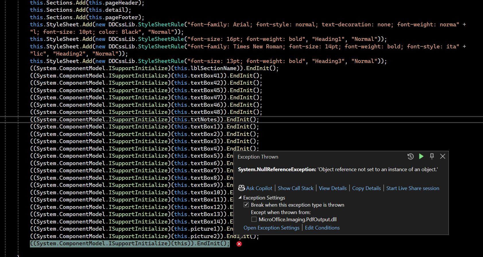

    Since upgrading from v11 to v18, I’m getting random NullReferenceExceptions in the “EndInit()” of the SectionReport.
    . I’ve tried moving things around beforehand, changing the default GDI+ to CrossPlatform, but nothing has helped. It’s essentially unusable. HELP!!
    It also occurs sometimes in the Sections.Add(…) in the designer.
    Here’s the end of the stack trace:
    2025-03-27 07:53:47 System.NullReferenceException: Object reference not set to an instance of an object. (source: System) [ at System.ComponentModel.TypeDescriptor.GetPropertiesImpl(Object component, Attribute attributes, Boolean noCustomTypeDesc, Boolean noAttributes)
    at GrapeCity.ActiveReports.SectionReportModel.ControlCollection.SetStyleSheet(StyleSheet value)
    at GrapeCity.ActiveReports.SectionCollection.Insert(Int32 index, Section section)
    at GrapeCity.ActiveReports.SectionCollection.OnReportInitializationCompleted(Object sender,  e)
    at GrapeCity.ActiveReports.SectionReport.System.ComponentModel.ISupportInitialize.EndInit()
  • Posted 30 March 2025, 6:23 pm EST
    I believe this is now solved. It appears I had some “side” DLLs like System.Memory.dll, System.Buffers.dll, etc… that were not consistent across all of my projects and ActiveReports was running with some older DLLs than it should have.
