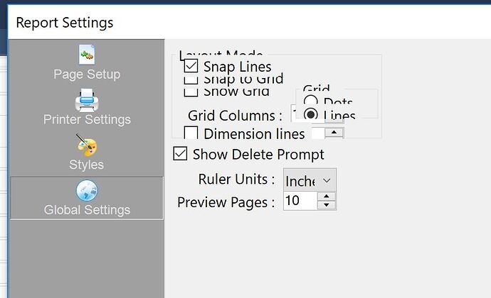

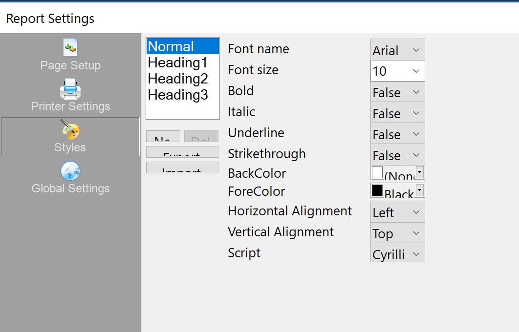

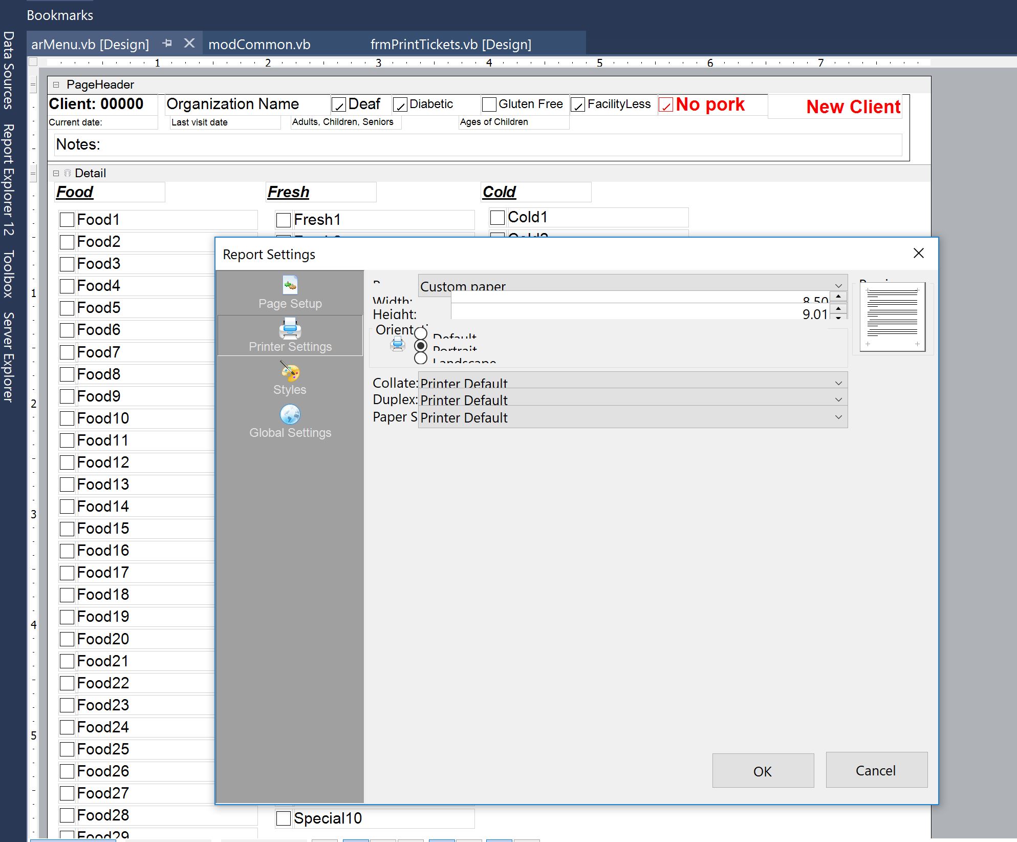

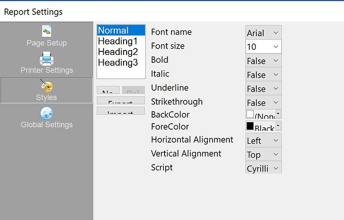

    When I am on the “Report Settings” dialog box, in the “Printer Settings” tab, the display is garbled.
    The other tabs “Styles”, and “Global Settings” are also garbled.
    The only tab that displays correctly is “Page Setup”
    I’ve closed and restarted Visual Studio, but no help.

    Additional information:
    Windows 10
    Dell XPS 15 9560
    LG 24UD58-B 24-Inch 4K UHD IPS External Monitor
    Resolution: 3840 x 2160
    Text scale: 225%
