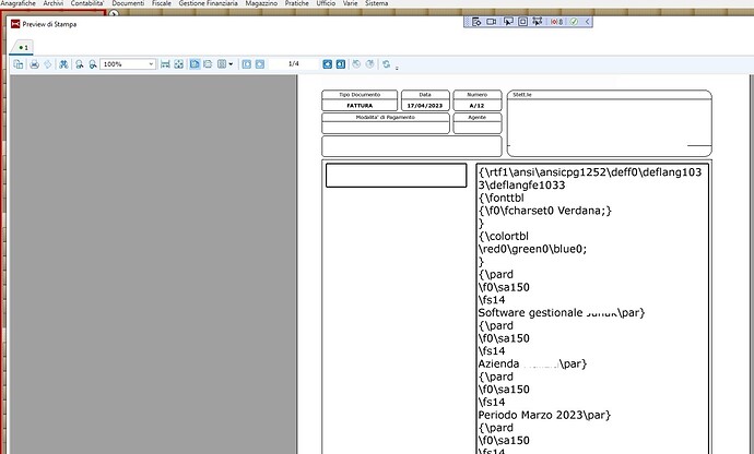

    Hi, i have a strange problem with activereport17 richtextbox component,
    Im using sectionreport and xml source.
    Basically in design preview its working correctly, but a runtime the ritchtextbox is blank.
    I attach 2 pictures, 1 in design mode, 1 at runtime,
    for show better the situation i have on the left a richtextbox and on the right a textbox, both linked at the same field.
    As you can see at runtime i cannot see the rtf text in the richthexbox.
    (i had any problem with the old version 8)
    Any idea ?

  • Posted 20 April 2023, 4:29 pm EST
    Hi, i saw that your project is framework 4.8, but i have the problem with .NET
    I migrated your project in .NET6 and the richtextbox does not show anything
    so the problem is in the .net version

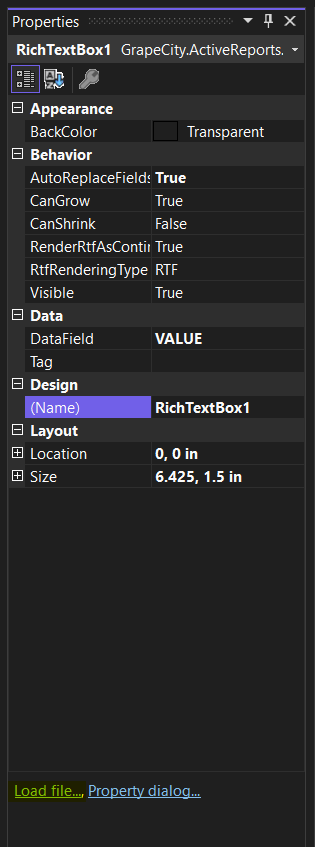

    Why i cannot see the Html and RTF properties in the report a design time ?
    Thank you
  • Posted 27 April 2023, 3:44 pm EST - Updated 27 April 2023, 3:50 pm EST
    Hello Beniamino,
    The code would be very similar in .Net 7 as this is a very simplified sample. I have attached a .Net Sample along with.
    The properties are not showing in the Properties Tab as it is ideal to use Load Files option if RTF/HTML file is used at Design-time, See attached screenshot. As loading the file will automatically save the file in the Report Resources in a ‘renderable format’ which is HTML. As the RTF to HTML conversion is not 100% WYSIWYG we do not provide a runtime conversion feature as of now though, this feature is currently under discussion.
