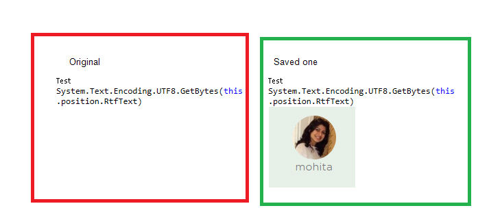

  • Posted 18 June 2020, 10:26 am EST - Updated 30 September 2022, 5:05 pm EST
    The image is now displayed, but the control on the report is not resized as it should and after your save, the format of the RTF seems a bit different now (text indented). You can see the two images in the my grid.
    and in the report
    I also tried to “simplify” the RTF by inserting it into a common .NET Framework RichTextBox and save it from there to a stream. But that’s a bit awful and doesn’t work either. Any suggestions?
  • Posted 19 June 2020, 5:41 am EST - Updated 30 September 2022, 5:05 pm EST
    Can you try after Setting the “CanGrow” property of the RichTextBox control to “True”?
    I am unable to reproduce the issue at my end. Please refer to the attached report and image.
