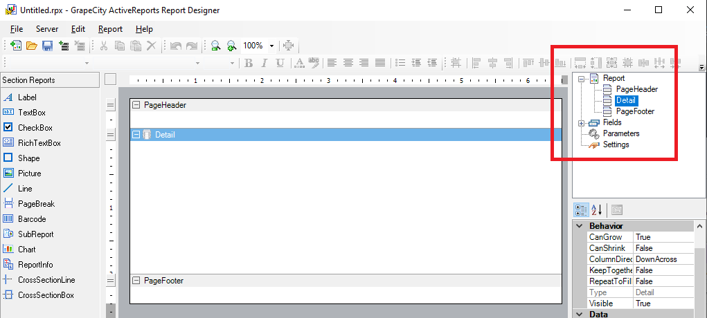

    Can you please advise how to change Report Explorer/Report Contents (see attachment) for Section Reports so it is displayed in “right to left mode”?

    You can use the following line of code:
    (reportExplorer.Controls[0].Controls[0] as TreeView).RightToLeftLayout = true;
    However, it has some issue which I am discussing with dev team (AR-25999) and will update you once I get any information from them.

  • Posted 24 February 2021, 11:09 am EST
    You wrote: “it has some issue” - what issue do you mean?
    Selected node is displayed on the Left side. Also, Context Menu appear on the left side.

  • Posted 1 March 2021, 11:17 am EST
    This issue is fixed in the internal build and will release in the AR15.1

  • Posted 9 March 2021, 1:11 am EST
    Selected node is displayed on the Left side is the issue we have fixed in the AR15.1. Could you please share the stripped down sample so that we can look into the issue.
